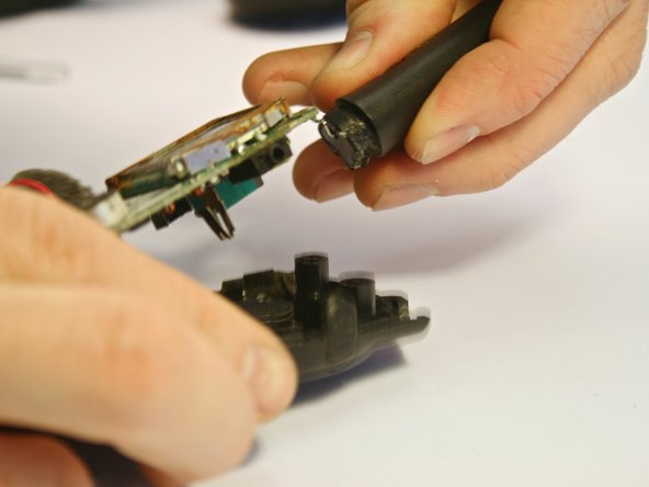

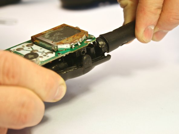

  9. Motorola Talkabout FV700R Battery Terminals Replacement, Battery Terminals: crwdns2935265:09crwdnd2935265:01crwdnd2935265:03crwdne2935265:0 Motorola Talkabout FV700R Battery Terminals Replacement, Battery Terminals: crwdns2935265:09crwdnd2935265:02crwdnd2935265:03crwdne2935265:0 Motorola Talkabout FV700R Battery Terminals Replacement, Battery Terminals: crwdns2935265:09crwdnd2935265:03crwdnd2935265:03crwdne2935265:0
    • Now the circuit board can be removed from the back faceplate.
    • To do this, grip the back faceplate in one hand and the antenna in the other. Pull and twist the antenna away from the back faceplate. The circuit board should be removed with the antenna, as they are attached.

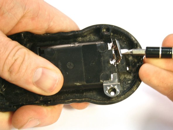

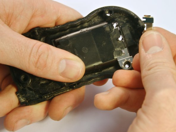

  10. Motorola Talkabout FV700R Battery Terminals Replacement: crwdns2935265:010crwdnd2935265:01crwdnd2935265:03crwdne2935265:0 Motorola Talkabout FV700R Battery Terminals Replacement: crwdns2935265:010crwdnd2935265:02crwdnd2935265:03crwdne2935265:0 Motorola Talkabout FV700R Battery Terminals Replacement: crwdns2935265:010crwdnd2935265:03crwdnd2935265:03crwdne2935265:0
    • Once the circuit board is removed from the back plate of the radio, the battery terminals can be removed.
    • From the front side of the two-way radio, use the flathead screwdriver to pry the longer battery terminals up and out of the radio.

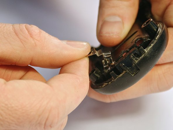

  11. Motorola Talkabout FV700R Battery Terminals Replacement: crwdns2935265:011crwdnd2935265:01crwdnd2935265:02crwdne2935265:0 Motorola Talkabout FV700R Battery Terminals Replacement: crwdns2935265:011crwdnd2935265:02crwdnd2935265:02crwdne2935265:0
    • To remove the smaller batter terminals, you'll need to turn the radio back over to the back side.
    • Use the flathead screwdriver to push on the terminal.
    • This may take some force.
    • Once the terminal is loose, you can turn the radio over and remove it with your hand.
