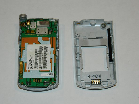

  5. Motorola T720c Keypad replacement or cleaning: crwdns2935265:05crwdnd2935265:01crwdnd2935265:02crwdne2935265:0 Motorola T720c Keypad replacement or cleaning: crwdns2935265:05crwdnd2935265:02crwdnd2935265:02crwdne2935265:0
    • Using a spudger (not shown), separate by gently prying the front from the back of the phone housing.
    • Remove the back.

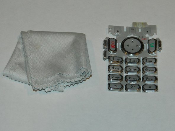

  8. Motorola T720c Keypad replacement or cleaning: crwdns2935265:08crwdnd2935265:01crwdnd2935265:02crwdne2935265:0 Motorola T720c Keypad replacement or cleaning: crwdns2935265:08crwdnd2935265:02crwdnd2935265:02crwdne2935265:0
    • Using a lens cloth, wipe away any build-up on or between the keys.
    • Wait for the keypad to dry before reassembling.
