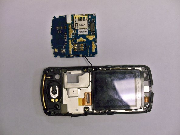

    • Using the flat end of the iFixit Opening Tool, carefully disconnect the two connectors from their sockets on the motherboard.
  6. Motorola Slvr L7 Keypad Replacement: crwdns2935265:06crwdnd2935265:01crwdnd2935265:01crwdne2935265:0
    • Use the iFixit Opening Tool to pry the antenna cable connectors from the motherboard.
    • Remove the antenna cable by pulling it out.

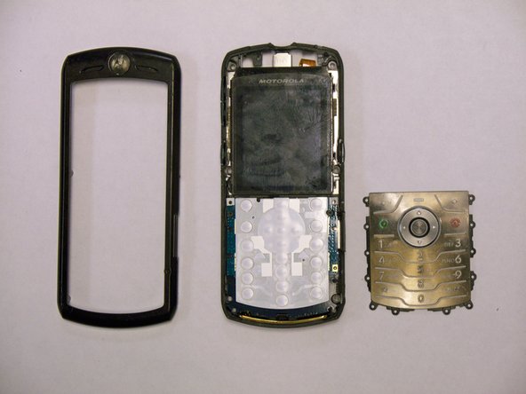

    • Now turn the phone over. Insert the iFixit Opening Tool between the frame and the outer case on the side of the phone.
    • Apply pressure using the iFixit Opening Tool to pry the case apart. Some force is required as the frame is attached by several clips. The first clip will be the hardest to dislodge.
    • As soon as the first clip is dislodged, work the tool around the entire edge of the phone to carefully remove the remaining clips. This will avoid breaking the frame.
    • Once the frame is completely separated from the outer case, remove the top numerical layer of the keypad by lifting it up.
  10. Motorola Slvr L7 Keypad Replacement: crwdns2935265:010crwdnd2935265:01crwdnd2935265:02crwdne2935265:0 Motorola Slvr L7 Keypad Replacement: crwdns2935265:010crwdnd2935265:02crwdnd2935265:02crwdne2935265:0
    • Carefully insert the flat end of the iFixit Opening Tool under the keyboard and pry it off.
