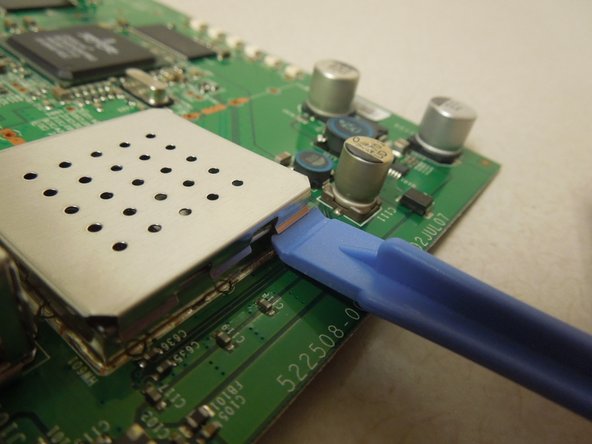

  6. Motorola SURFboard SB5101 Metal Receiver Replacement, Positioning the Prying Tool: crwdns2935265:06crwdnd2935265:01crwdnd2935265:02crwdne2935265:0 Motorola SURFboard SB5101 Metal Receiver Replacement, Positioning the Prying Tool: crwdns2935265:06crwdnd2935265:02crwdnd2935265:02crwdne2935265:0
    • Holding the motherboard by the metal face plate, position the flat end of a prying tool under one of the prongs of the metal square plate.

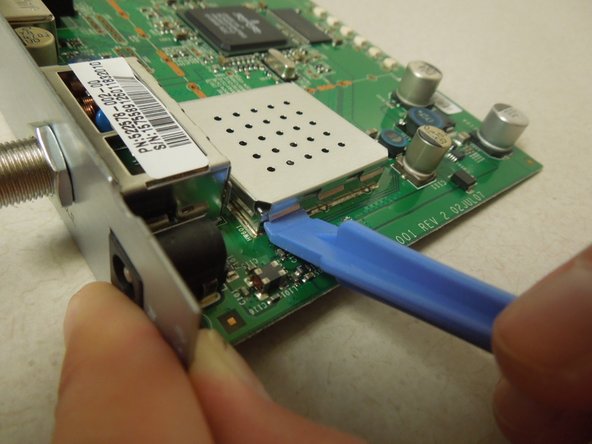

  7. Motorola SURFboard SB5101 Metal Receiver Replacement, Pivoting the Prying Tool: crwdns2935265:07crwdnd2935265:01crwdnd2935265:02crwdne2935265:0 Motorola SURFboard SB5101 Metal Receiver Replacement, Pivoting the Prying Tool: crwdns2935265:07crwdnd2935265:02crwdnd2935265:02crwdne2935265:0
    • Slowly and evenly tilt the prying tool so that the metal plate begins to lift up.
  8. Motorola SURFboard SB5101 Metal Receiver Replacement, Lifting Another Corner: crwdns2935265:08crwdnd2935265:01crwdnd2935265:02crwdne2935265:0 Motorola SURFboard SB5101 Metal Receiver Replacement, Lifting Another Corner: crwdns2935265:08crwdnd2935265:02crwdnd2935265:02crwdne2935265:0
    • Re-position the prying tool underneath another metal prong on the metal face plate, as described in Step 1.
    • Again, gently tilt the prying tool to lift the metal plate.

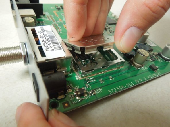

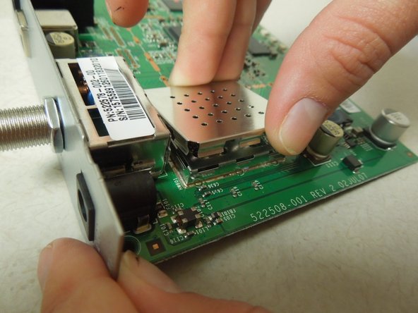

  9. Motorola SURFboard SB5101 Metal Receiver Replacement, Lifting the Metal Plate from the Motherboard: crwdns2935265:09crwdnd2935265:01crwdnd2935265:03crwdne2935265:0 Motorola SURFboard SB5101 Metal Receiver Replacement, Lifting the Metal Plate from the Motherboard: crwdns2935265:09crwdnd2935265:02crwdnd2935265:03crwdne2935265:0 Motorola SURFboard SB5101 Metal Receiver Replacement, Lifting the Metal Plate from the Motherboard: crwdns2935265:09crwdnd2935265:03crwdnd2935265:03crwdne2935265:0
    • Remove the prying tool and set aside.
    • Using one hand, gently grab the sides of the metal plate and lift away from the motherboard.
    • If the metal plate does not remove easily, tilt it as you lift the metal plate. If the metal plate is still attached, use the prying tool to detach more metal prongs.
To replace the metal plate, position it over the metal frame and gently press it down until it clicks into place.
