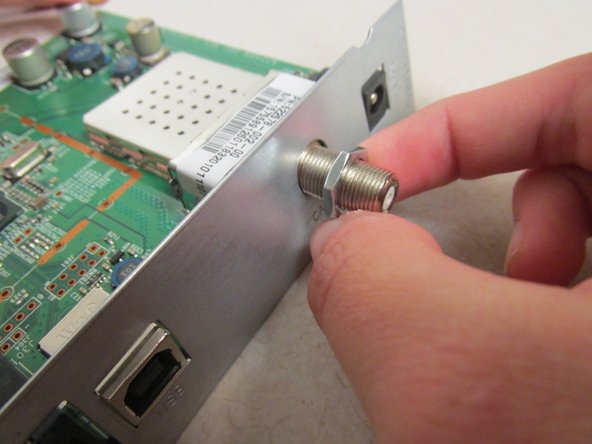

  6. Motorola SURFboard SB5101 Face Plate Replacement, Unscrew the Silver Antennae Jack Screw: crwdns2935265:06crwdnd2935265:01crwdnd2935265:03crwdne2935265:0 Motorola SURFboard SB5101 Face Plate Replacement, Unscrew the Silver Antennae Jack Screw: crwdns2935265:06crwdnd2935265:02crwdnd2935265:03crwdne2935265:0 Motorola SURFboard SB5101 Face Plate Replacement, Unscrew the Silver Antennae Jack Screw: crwdns2935265:06crwdnd2935265:03crwdnd2935265:03crwdne2935265:0
    • Begin by grabbing the washer on the silver antennae jack screw.
    • Start unscrewing the washer by turning it counterclockwise.

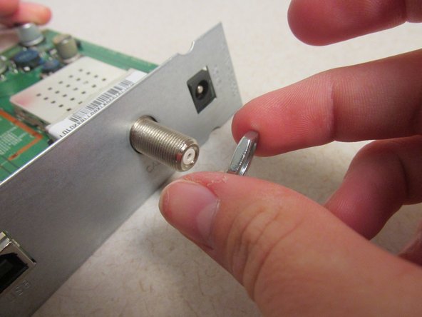

    • Continue to unscrew the washer until it comes off the screw.
    • If you cannot unscrew the washer with your finger, you may need to use a small wrench to grab the washer.
    • Set the washer aside.

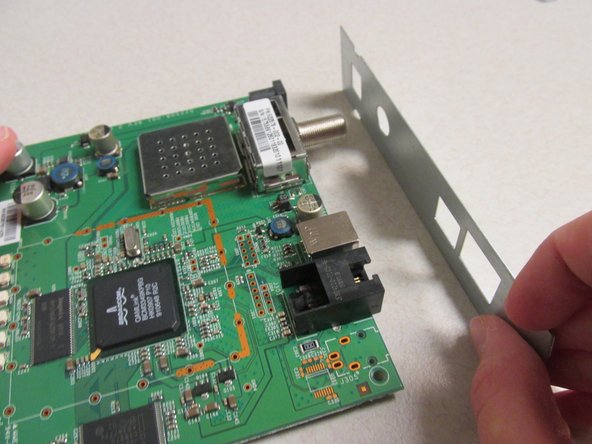

  7. Motorola SURFboard SB5101 Face Plate Replacement, Removing the Face Plate: crwdns2935265:07crwdnd2935265:01crwdnd2935265:02crwdne2935265:0 Motorola SURFboard SB5101 Face Plate Replacement, Removing the Face Plate: crwdns2935265:07crwdnd2935265:02crwdnd2935265:02crwdne2935265:0
    • Grab both corner ends of the silver face plate.
    • Gently pull the face plate away from the router, gently wiggling it off the screw.
