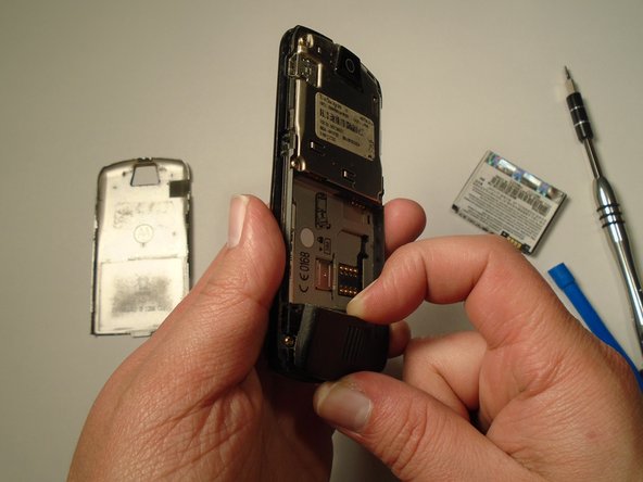

  6. Motorola SLVR L9 Keypad Replacement: crwdns2935265:06crwdnd2935265:01crwdnd2935265:01crwdne2935265:0
    • Remove the four housing screws (1/8") from each corner of the transceiver PC board shield. Use a screwdriver with a T6 Torx screwdriver head to turn the screws counter-clockwise (left).
  7. Motorola SLVR L9 Keypad Replacement: crwdns2935265:07crwdnd2935265:01crwdnd2935265:02crwdne2935265:0 Motorola SLVR L9 Keypad Replacement: crwdns2935265:07crwdnd2935265:02crwdnd2935265:02crwdne2935265:0
    • Once you have removed all of the screws, lift the transceiver PC board shield up to remove it.

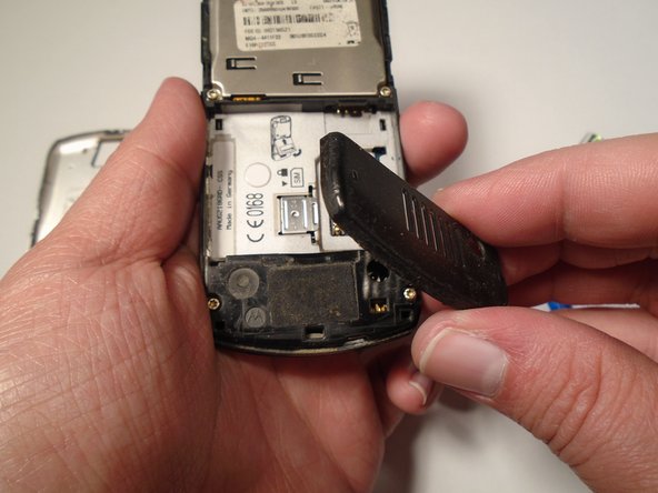

  8. Motorola SLVR L9 Keypad Replacement, Antenna Cover: crwdns2935265:08crwdnd2935265:01crwdnd2935265:03crwdne2935265:0 Motorola SLVR L9 Keypad Replacement, Antenna Cover: crwdns2935265:08crwdnd2935265:02crwdnd2935265:03crwdne2935265:0 Motorola SLVR L9 Keypad Replacement, Antenna Cover: crwdns2935265:08crwdnd2935265:03crwdnd2935265:03crwdne2935265:0
    • Use the plastic opening tool to loosen the cover latch.
    • Once the cover latch has been loosened, gently pull the cover latch off of the device.

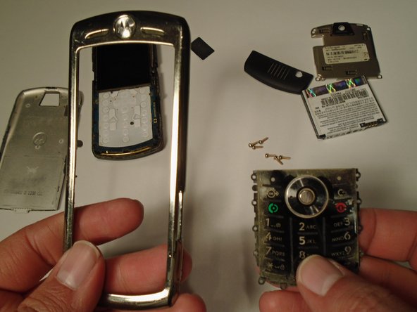

    • Using the grooves around the edge of the phone, gently pull the front plate away from the phone until it is fully removed from the device.
  11. Motorola SLVR L9 Keypad Replacement: crwdns2935265:011crwdnd2935265:01crwdnd2935265:02crwdne2935265:0 Motorola SLVR L9 Keypad Replacement: crwdns2935265:011crwdnd2935265:02crwdnd2935265:02crwdne2935265:0
    • Lift the keypad up from the front plate to remove.
