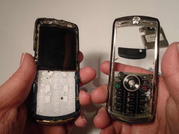

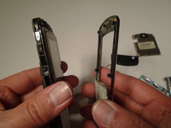

  9. Motorola SLVR L9 Front Panel Replacement, Front Panel: crwdns2935265:09crwdnd2935265:01crwdnd2935265:01crwdne2935265:0
    • Use a screwdriver with a T6 Torx screwdriver head to turn the screw counter-clockwise (left).
  10. Motorola SLVR L9 Front Panel Replacement: crwdns2935265:010crwdnd2935265:01crwdnd2935265:03crwdne2935265:0 Motorola SLVR L9 Front Panel Replacement: crwdns2935265:010crwdnd2935265:02crwdnd2935265:03crwdne2935265:0 Motorola SLVR L9 Front Panel Replacement: crwdns2935265:010crwdnd2935265:03crwdnd2935265:03crwdne2935265:0
    • Using the grooves around the edge of the phone, gently pull the front panel away from the phone until it is fully removed from the device.
