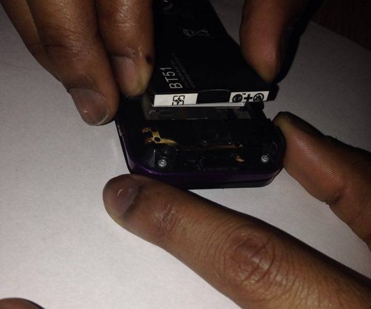

    • Lift the battery from its compartment to remove it.

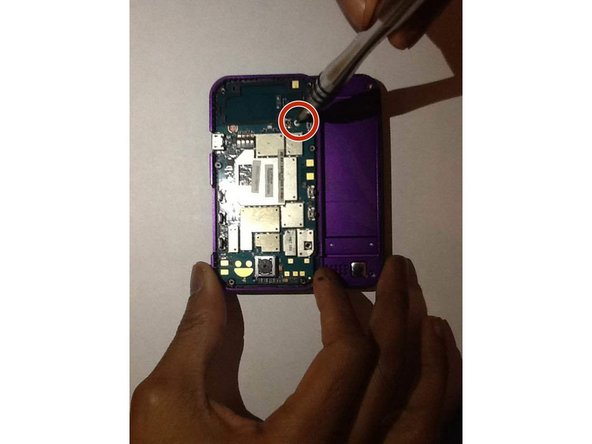

    • Use a Phillips #00 screwdriver to remove the six screws around the edge of the device.

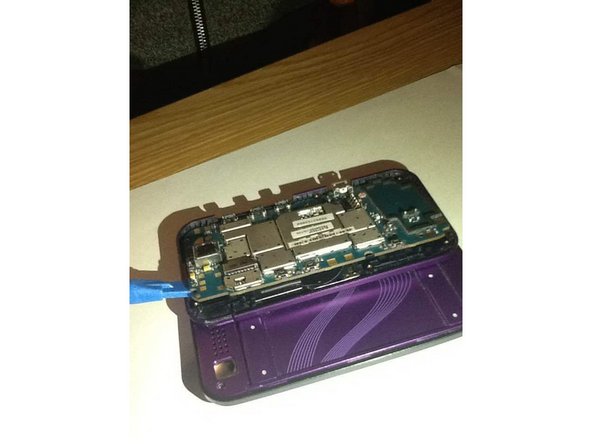

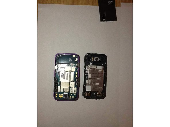

    • Insert the iFixit Opening Tool into the seam where the front and back panels meet and work your way around the perimeter to separate the two panels.
    • Once the two panels are separated, set the front panel to the side. You will be working with the back panel to access the keyboard.
    • The motherboard is now exposed on the back panel.

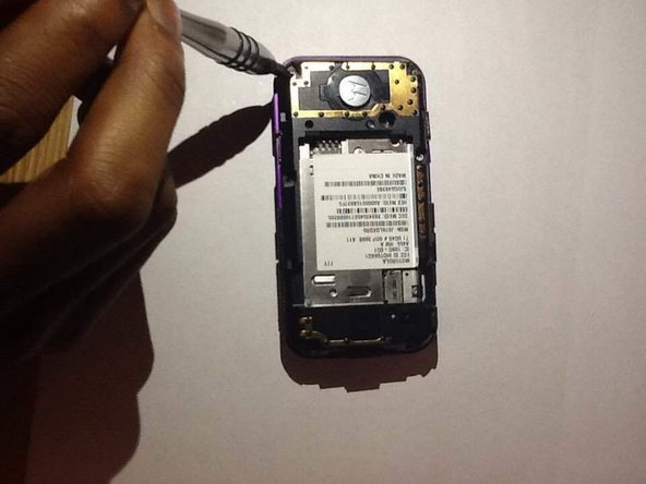

    • Slide the keyboard out.
    • Use a Phillips #00 screwdriver to remove all of the screws.

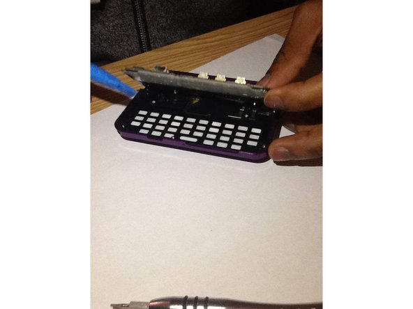

    • Insert the iFixit Opening Tool under the edges of the motherboard to lift it out of the back panel and expose the keyboard.
  10. Motorola Rival Keyboard Replacement: crwdns2935265:010crwdnd2935265:01crwdnd2935265:01crwdne2935265:0
    • Remove the old keyboard from the frame.
    • Place the new keyboard into the frame and align the buttons into their respective openings.
