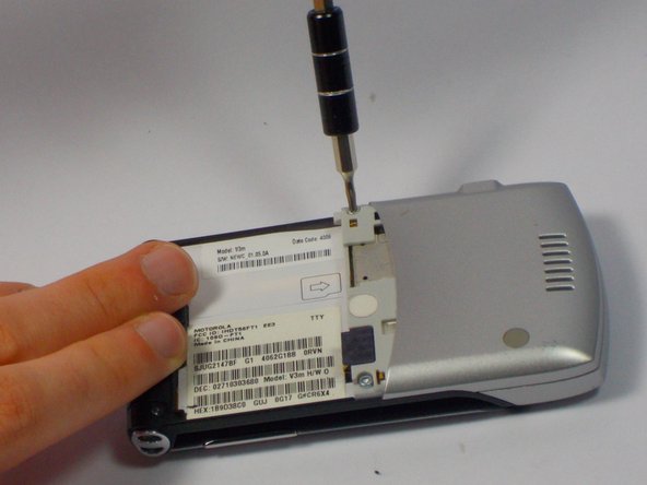

  4. Motorola Razr V3m Speaker Replacement, Antenna: crwdns2935265:04crwdnd2935265:01crwdnd2935265:02crwdne2935265:0 Motorola Razr V3m Speaker Replacement, Antenna: crwdns2935265:04crwdnd2935265:02crwdnd2935265:02crwdne2935265:0
    • Remove the two screws from the back panel with a T6 screwdriver.

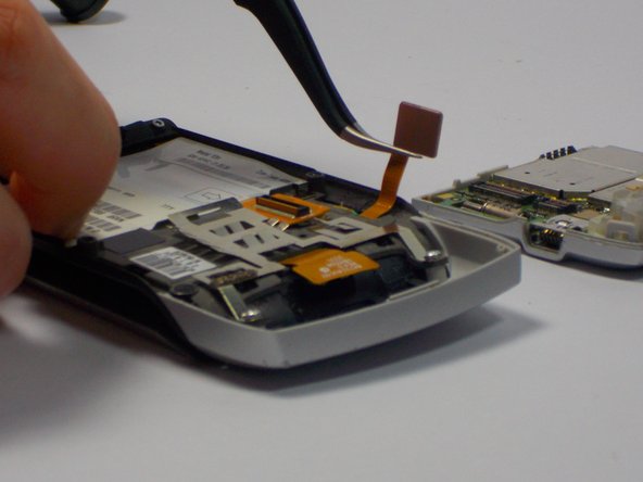

  6. Motorola Razr V3m Speaker Replacement: crwdns2935265:06crwdnd2935265:01crwdnd2935265:02crwdne2935265:0 Motorola Razr V3m Speaker Replacement: crwdns2935265:06crwdnd2935265:02crwdnd2935265:02crwdne2935265:0
    • Use tweezers to disconnect the copper ribbon from the inside of the back panel.

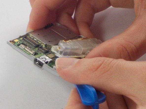

  8. Motorola Razr V3m Speaker Replacement: crwdns2935265:08crwdnd2935265:01crwdnd2935265:02crwdne2935265:0 Motorola Razr V3m Speaker Replacement: crwdns2935265:08crwdnd2935265:02crwdnd2935265:02crwdne2935265:0
    • Use a plastic opening tool to pry the edge of the antenna away from back panel.
    • The antenna may be fastened with two grey clips on either side. If this is so, unfasten two plastic clips located on the edge of the antenna.
    • Lift antenna away from back panel.
