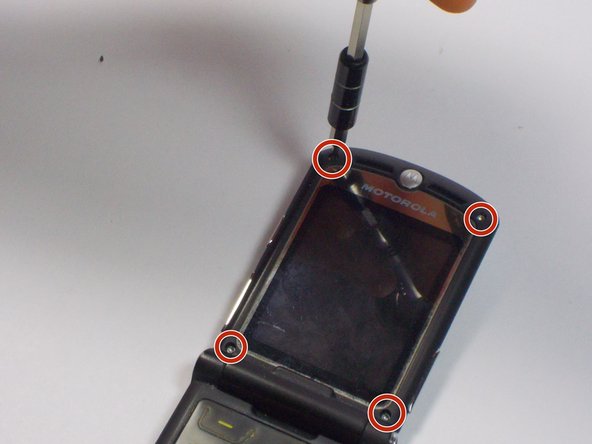

    • Remove the 4 screws on the corners of the inside screen with the T4 screwdriver
    • The phone may have rubber plugs covering the screws of the inside screen. If so, remove the rubber plugs with a thin metal needle.
