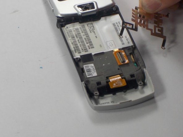

  5. Motorola Razr V3m Keypad Cover Replacement: crwdns2935265:05crwdnd2935265:01crwdnd2935265:01crwdne2935265:0
    • Carefully use a metal spudger to pry back panel open.
    • The back panel is attached to the phone with a copper ribbon that acts as a hinge.
    • Carefully open out the back panel to the side of the phone corresponding with the hinge.
    • Do not pull back away from phone. It may damage the copper ribbon.

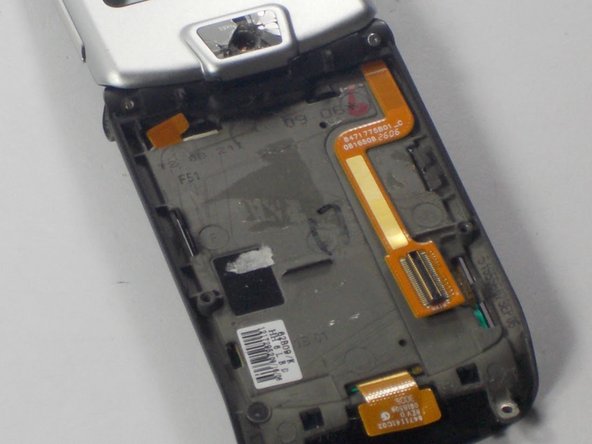

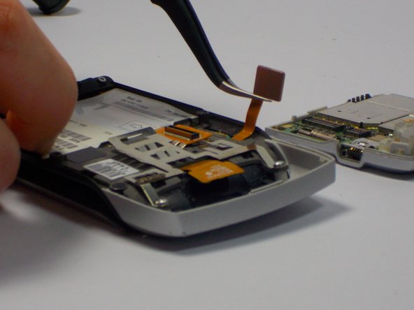

  6. Motorola Razr V3m Keypad Cover Replacement: crwdns2935265:06crwdnd2935265:01crwdnd2935265:02crwdne2935265:0 Motorola Razr V3m Keypad Cover Replacement: crwdns2935265:06crwdnd2935265:02crwdnd2935265:02crwdne2935265:0
    • Use tweezers to disconnect the copper ribbon from the inside of the back panel.

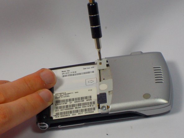

  7. Motorola Razr V3m Keypad Cover Replacement: crwdns2935265:07crwdnd2935265:01crwdnd2935265:02crwdne2935265:0 Motorola Razr V3m Keypad Cover Replacement: crwdns2935265:07crwdnd2935265:02crwdnd2935265:02crwdne2935265:0
    • Use a T6 Torx bit screwdriver to remove the two screws holding the cover down.
    • The metal shield will come off with the screws; don't forget to reattach it before replacing the screws.

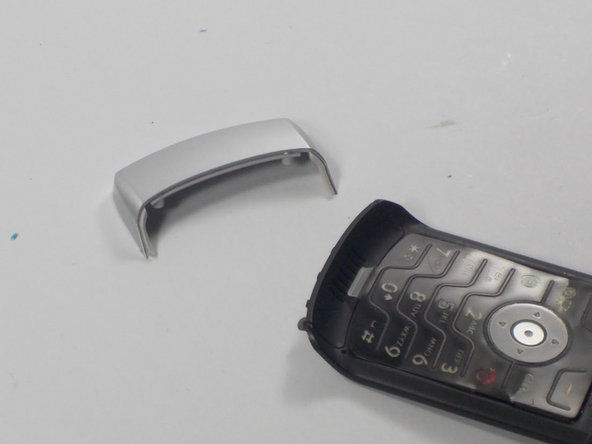

  8. Motorola Razr V3m Keypad Cover Replacement: crwdns2935265:08crwdnd2935265:01crwdnd2935265:02crwdne2935265:0 Motorola Razr V3m Keypad Cover Replacement: crwdns2935265:08crwdnd2935265:02crwdnd2935265:02crwdne2935265:0
    • Remove the keypad cover, located below the keypad on the front of the phone.

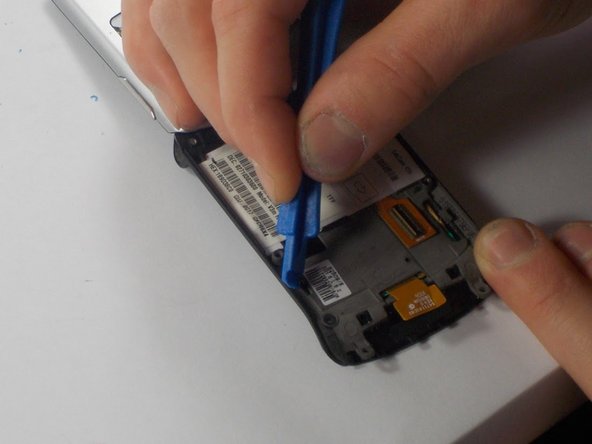

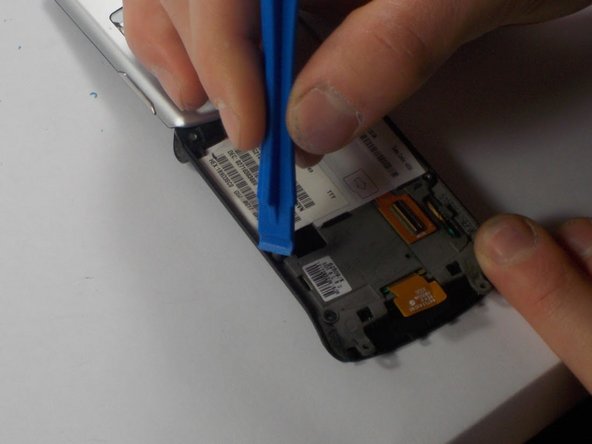

  10. Motorola Razr V3m Keypad Cover Replacement: crwdns2935265:010crwdnd2935265:01crwdnd2935265:03crwdne2935265:0 Motorola Razr V3m Keypad Cover Replacement: crwdns2935265:010crwdnd2935265:02crwdnd2935265:03crwdne2935265:0 Motorola Razr V3m Keypad Cover Replacement: crwdns2935265:010crwdnd2935265:03crwdnd2935265:03crwdne2935265:0
    • Using a plastic opening tool, push the four metal tabs along the edge of the phone in towards the keypad.

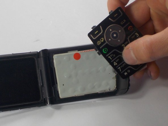

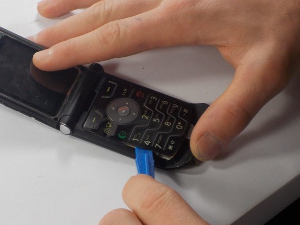

  11. Motorola Razr V3m Keypad Cover Replacement: crwdns2935265:011crwdnd2935265:01crwdnd2935265:03crwdne2935265:0 Motorola Razr V3m Keypad Cover Replacement: crwdns2935265:011crwdnd2935265:02crwdnd2935265:03crwdne2935265:0 Motorola Razr V3m Keypad Cover Replacement: crwdns2935265:011crwdnd2935265:03crwdnd2935265:03crwdne2935265:0
    • Using the plastic opening tool, pry the edges of the keypad until it is loose. Then, pull it off.
    • It is easiest to work your way from left to right when loosening the case.
