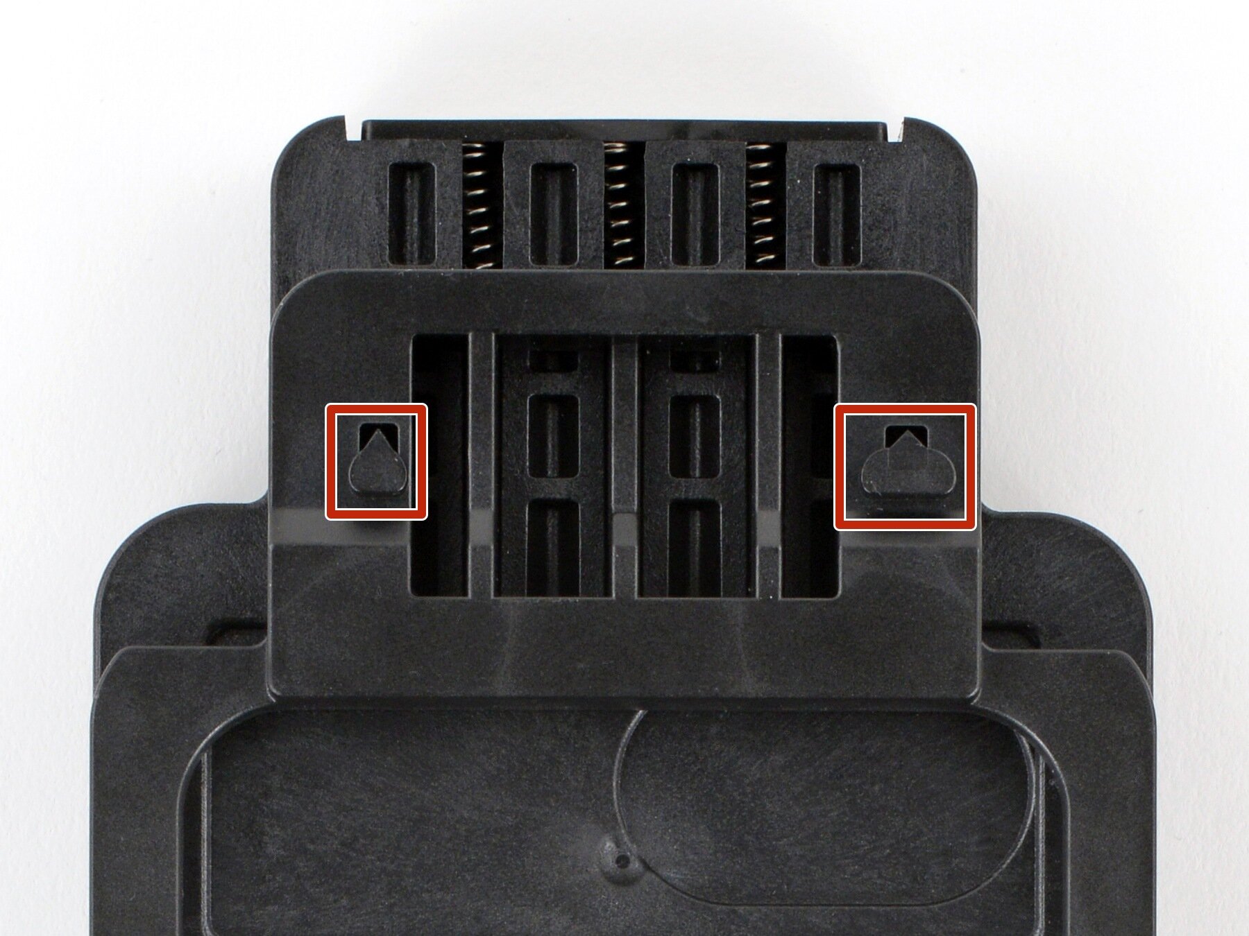

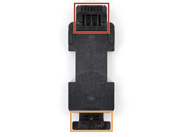

    • Before starting your repair, familiarize yourself with the different parts of the alignment adapter:
    • The top of the adapter has a spring‑loaded adjuster and hooks that align the screen protector.
    • The bottom of the adapter has a charging port holder (held in place by a screw) and alignment posts for the screen protector.

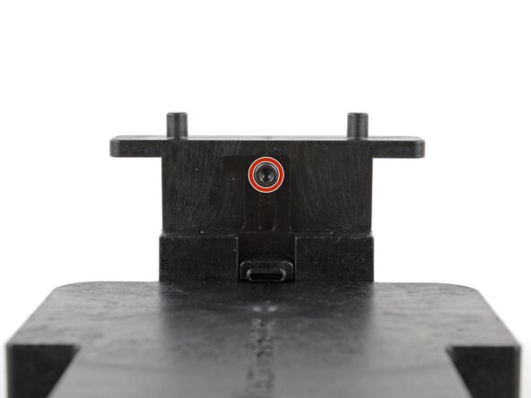

  2. Motorola Razr 40 Screen Protector Replacement, Loosen the charging port holder screw: crwdns2935265:02crwdnd2935265:01crwdnd2935265:02crwdne2935265:0 Motorola Razr 40 Screen Protector Replacement, Loosen the charging port holder screw: crwdns2935265:02crwdnd2935265:02crwdnd2935265:02crwdne2935265:0
    • Use a 2.5 mm hex screwdriver to loosen (not remove) the screw securing the charging port holder.
