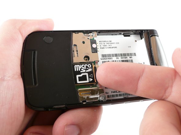

    1. Motorola RAZR2 v9m SD Card Replacement, SD Card: crwdns2935265:05crwdnd2935265:01crwdnd2935265:02crwdne2935265:0 Motorola RAZR2 v9m SD Card Replacement, SD Card: crwdns2935265:05crwdnd2935265:02crwdnd2935265:02crwdne2935265:0
      • Press the exposed portion of the SD card towards the bottom of the phone until you hear a click. The SD card will slide into the phone about 10 mm.

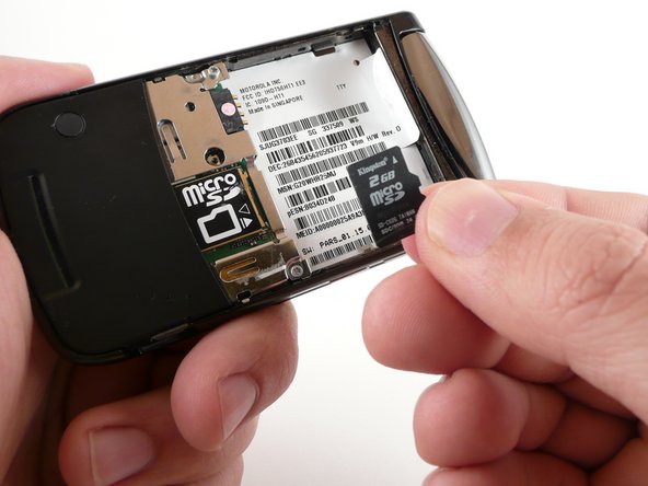

    2. Motorola RAZR2 v9m SD Card Replacement: crwdns2935265:06crwdnd2935265:01crwdnd2935265:02crwdne2935265:0 Motorola RAZR2 v9m SD Card Replacement: crwdns2935265:06crwdnd2935265:02crwdnd2935265:02crwdne2935265:0
      • Release the SD card. A spring will push it partially out of the phone.
      • Grasp the card by the edges and remove.
      • When installing a new SD card, remember that it must be 2 GB or less.
