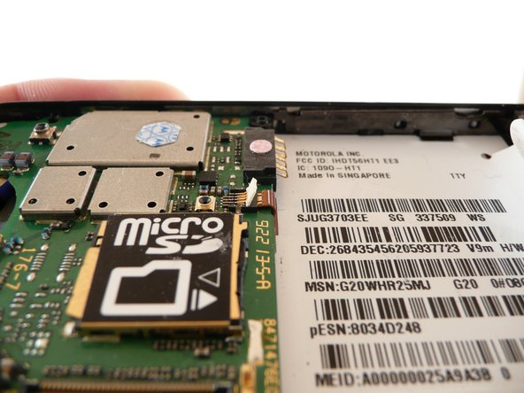

  9. Motorola RAZR2 v9m Motherboard Replacement: crwdns2935265:09crwdnd2935265:01crwdnd2935265:03crwdne2935265:0 Motorola RAZR2 v9m Motherboard Replacement: crwdns2935265:09crwdnd2935265:02crwdnd2935265:03crwdne2935265:0 Motorola RAZR2 v9m Motherboard Replacement: crwdns2935265:09crwdnd2935265:03crwdnd2935265:03crwdne2935265:0
    • Tilt the loosened half of the rear housing away from the phone. The housing should easily separate after tilting it about 45 degrees away from the phone.

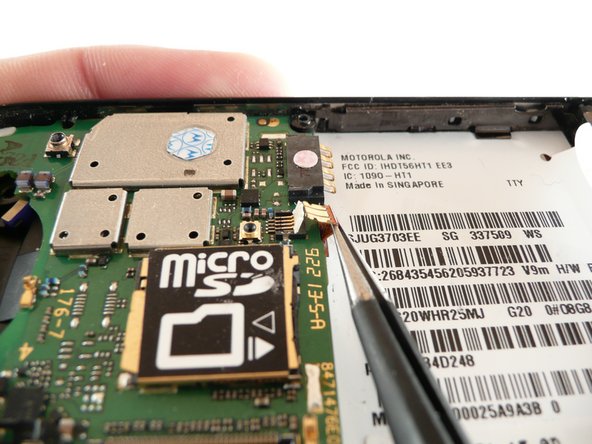

    • A small rubber cap (marked in red on the third image) loosely sits on the motherboard. It can easily fall off when removing the rear housing. Take care not to lose it.

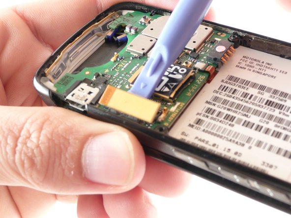

  10. Motorola RAZR2 v9m Motherboard Replacement, Motherboard: crwdns2935265:010crwdnd2935265:01crwdnd2935265:03crwdne2935265:0 Motorola RAZR2 v9m Motherboard Replacement, Motherboard: crwdns2935265:010crwdnd2935265:02crwdnd2935265:03crwdne2935265:0 Motorola RAZR2 v9m Motherboard Replacement, Motherboard: crwdns2935265:010crwdnd2935265:03crwdnd2935265:03crwdne2935265:0

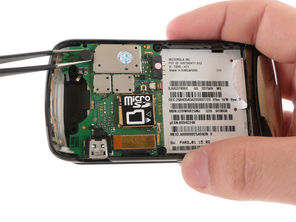

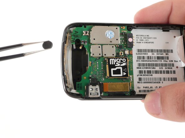

    • Use a pair of tweezers or your fingers to remove the small rubber cap from the motherboard.
  11. Motorola RAZR2 v9m Motherboard Replacement: crwdns2935265:011crwdnd2935265:01crwdnd2935265:03crwdne2935265:0 Motorola RAZR2 v9m Motherboard Replacement: crwdns2935265:011crwdnd2935265:02crwdnd2935265:03crwdne2935265:0 Motorola RAZR2 v9m Motherboard Replacement: crwdns2935265:011crwdnd2935265:03crwdnd2935265:03crwdne2935265:0

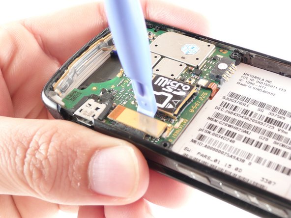

    • Use a plastic opening tool to gently pry the main motherboard cable connector away from the RAZR2.

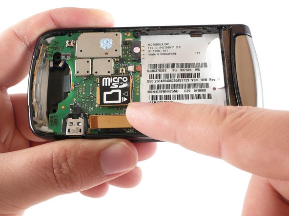

    • Use your finger to bend the connector away from the RAZR2.

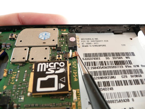

  13. Motorola RAZR2 v9m Motherboard Replacement: crwdns2935265:013crwdnd2935265:01crwdnd2935265:03crwdne2935265:0 Motorola RAZR2 v9m Motherboard Replacement: crwdns2935265:013crwdnd2935265:02crwdnd2935265:03crwdne2935265:0 Motorola RAZR2 v9m Motherboard Replacement: crwdns2935265:013crwdnd2935265:03crwdnd2935265:03crwdne2935265:0

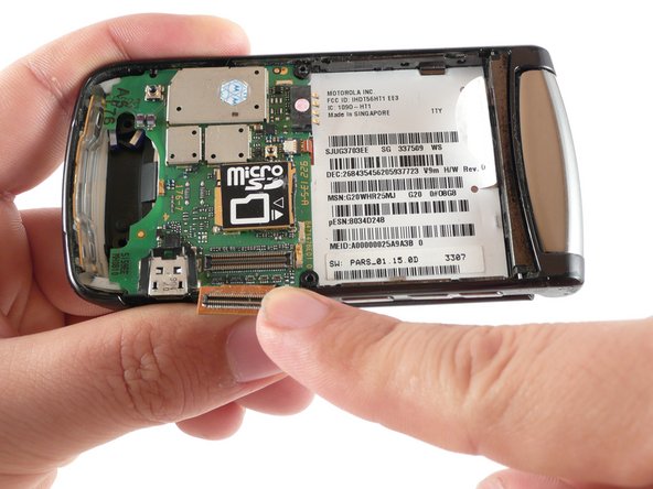

    • Use a spudger to flip open the white clamp holding the keypad ribbon in place.

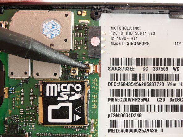

  14. Motorola RAZR2 v9m Motherboard Replacement: crwdns2935265:014crwdnd2935265:01crwdnd2935265:03crwdne2935265:0 Motorola RAZR2 v9m Motherboard Replacement: crwdns2935265:014crwdnd2935265:02crwdnd2935265:03crwdne2935265:0 Motorola RAZR2 v9m Motherboard Replacement: crwdns2935265:014crwdnd2935265:03crwdnd2935265:03crwdne2935265:0
    • Slide the tip of a pair of tweezers between the motherboard and the keyboard cable.
    • Slide the keyboard cable towards the top of the phone, away from the motherboard.

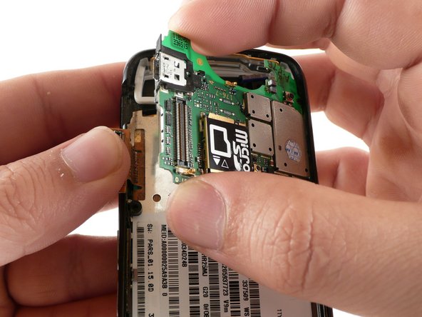

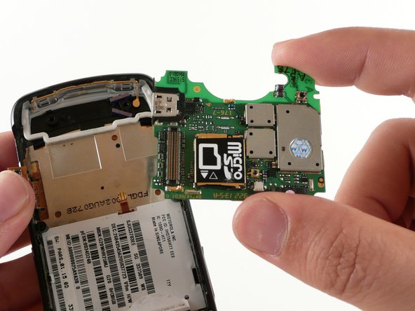

  15. Motorola RAZR2 v9m Motherboard Replacement: crwdns2935265:015crwdnd2935265:01crwdnd2935265:03crwdne2935265:0 Motorola RAZR2 v9m Motherboard Replacement: crwdns2935265:015crwdnd2935265:02crwdnd2935265:03crwdne2935265:0 Motorola RAZR2 v9m Motherboard Replacement: crwdns2935265:015crwdnd2935265:03crwdnd2935265:03crwdne2935265:0
    • While holding the main motherboard cable connector away from the RAZR2, gently lift the motherboard away from the phone.
