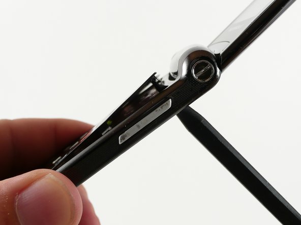

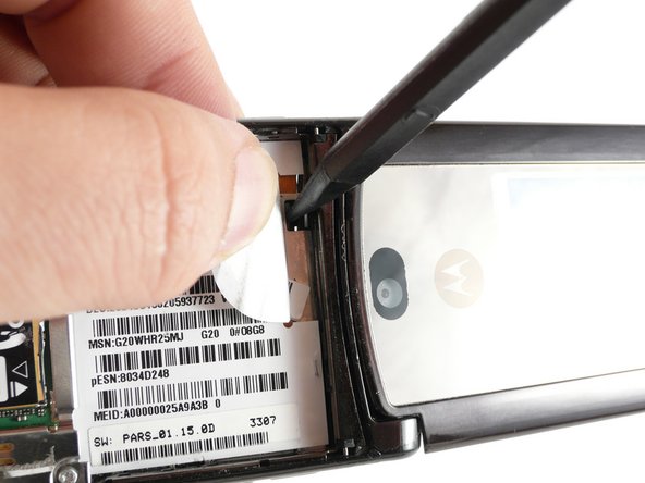

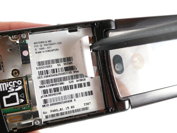

    1. Motorola RAZR2 v9m Keypad Replacement, Keypad: crwdns2935265:05crwdnd2935265:01crwdnd2935265:03crwdne2935265:0 Motorola RAZR2 v9m Keypad Replacement, Keypad: crwdns2935265:05crwdnd2935265:02crwdnd2935265:03crwdne2935265:0 Motorola RAZR2 v9m Keypad Replacement, Keypad: crwdns2935265:05crwdnd2935265:03crwdnd2935265:03crwdne2935265:0
      • Flip the RAZR2 open with the battery compartment facing you.
      • Pull the white battery tab away from the phone to reveal a small black gap in the battery compartment.
      • Place the spudger into this gap. Rest the spudger against the black plastic inside of the gap.

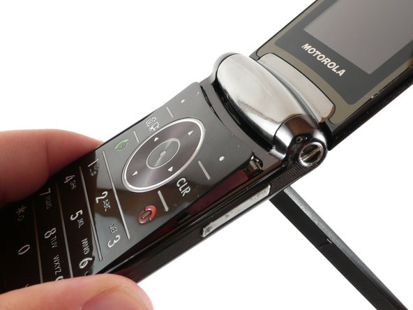

    2. Motorola RAZR2 v9m Keypad Replacement: crwdns2935265:06crwdnd2935265:01crwdnd2935265:03crwdne2935265:0 Motorola RAZR2 v9m Keypad Replacement: crwdns2935265:06crwdnd2935265:02crwdnd2935265:03crwdne2935265:0 Motorola RAZR2 v9m Keypad Replacement: crwdns2935265:06crwdnd2935265:03crwdnd2935265:03crwdne2935265:0
      • Rest the spudger/scewdriver between the top of the black plastic and the metal body of the phone and leaver the two apart to release the top clip on the keyboard.and the top of the keypad pops out from the RAZR2.

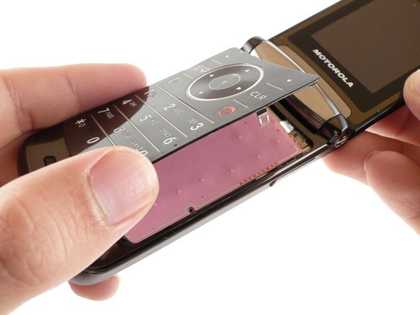

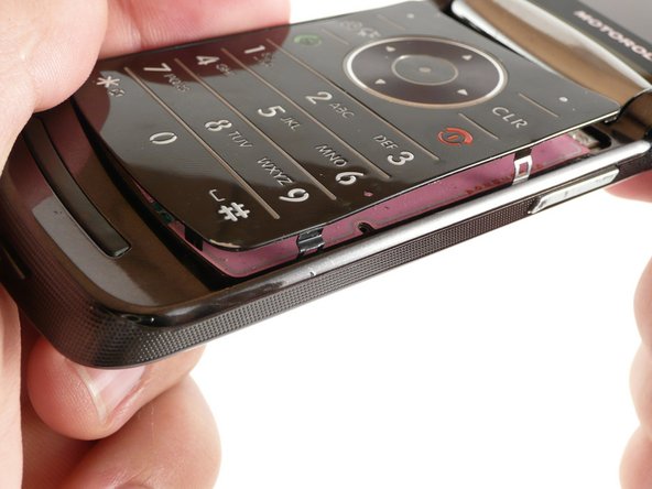

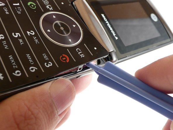

    3. Motorola RAZR2 v9m Keypad Replacement: crwdns2935265:07crwdnd2935265:01crwdnd2935265:03crwdne2935265:0 Motorola RAZR2 v9m Keypad Replacement: crwdns2935265:07crwdnd2935265:02crwdnd2935265:03crwdne2935265:0 Motorola RAZR2 v9m Keypad Replacement: crwdns2935265:07crwdnd2935265:03crwdnd2935265:03crwdne2935265:0
      • Use a plastic opening tool to gently pry one side of the keypad away from the RAZR2.
      • There are 2 clips on the side of the keypad. In total, there are 8 clips holding the keypad to the phone.

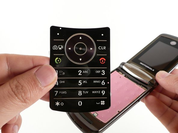

    4. Motorola RAZR2 v9m Keypad Replacement: crwdns2935265:08crwdnd2935265:01crwdnd2935265:03crwdne2935265:0 Motorola RAZR2 v9m Keypad Replacement: crwdns2935265:08crwdnd2935265:02crwdnd2935265:03crwdne2935265:0 Motorola RAZR2 v9m Keypad Replacement: crwdns2935265:08crwdnd2935265:03crwdnd2935265:03crwdne2935265:0
      • Lift the keypad away from the phone.
      • When reassembling, gently squeeze the sides of the keypad until the keypad has a slight bow running down the middle from top to bottom, like a playing card. This will ensure that it slides easily into place. Take care not to damage any of the 8 clips.
