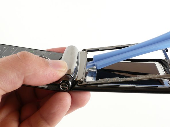

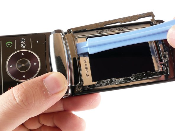

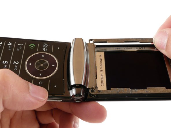

      • Use a plastic opening tool to pry the top end of the metal frame away from the RAZR2.
    5. Motorola RAZR2 v9m Camera Replacement: crwdns2935265:09crwdnd2935265:01crwdnd2935265:03crwdne2935265:0 Motorola RAZR2 v9m Camera Replacement: crwdns2935265:09crwdnd2935265:02crwdnd2935265:03crwdne2935265:0 Motorola RAZR2 v9m Camera Replacement: crwdns2935265:09crwdnd2935265:03crwdnd2935265:03crwdne2935265:0
      • Insert a plastic opening tool under the metal frame at the hinge of the RAZR2.
      • Gently pry the hinge portion of the metal frame away from the phone.
      • The metal frame is latched to the phone on the corner closest to the clear and end call buttons. Pry this part of the frame away last.

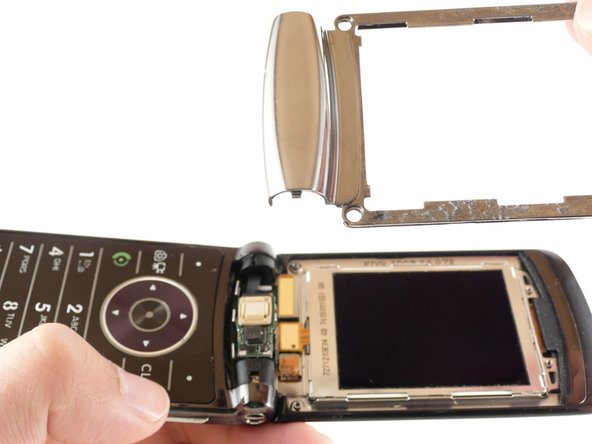

    6. Motorola RAZR2 v9m Camera Replacement: crwdns2935265:010crwdnd2935265:01crwdnd2935265:03crwdne2935265:0 Motorola RAZR2 v9m Camera Replacement: crwdns2935265:010crwdnd2935265:02crwdnd2935265:03crwdne2935265:0 Motorola RAZR2 v9m Camera Replacement: crwdns2935265:010crwdnd2935265:03crwdnd2935265:03crwdne2935265:0
      • Lift the frame away from the phone.
      • When reassembling, insert the latch on the metal frame into the phone before inserting any other part of the frame.
