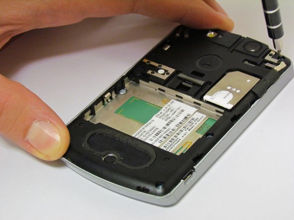

  5. Motorola Q Global Speakers Replacement: crwdns2935265:05crwdnd2935265:01crwdnd2935265:02crwdne2935265:0 Motorola Q Global Speakers Replacement: crwdns2935265:05crwdnd2935265:02crwdnd2935265:02crwdne2935265:0
    • Remove the six labeled screws with a T5 torx screw driver.
  6. Motorola Q Global Speakers Replacement: crwdns2935265:06crwdnd2935265:01crwdnd2935265:01crwdne2935265:0
    • Once the screws are removed, use the plastic opening tool to remove the black casing.
