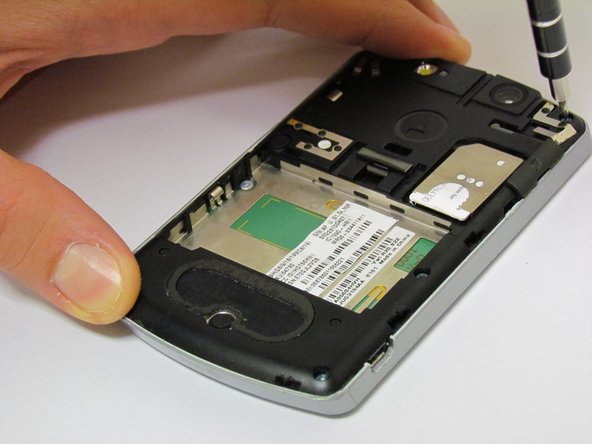

  5. Motorola Q Global Display screen Replacement: crwdns2935265:05crwdnd2935265:01crwdnd2935265:02crwdne2935265:0 Motorola Q Global Display screen Replacement: crwdns2935265:05crwdnd2935265:02crwdnd2935265:02crwdne2935265:0
    • Remove the 6 screws using the T5 torx screwdriver.
  6. Motorola Q Global Display screen Replacement: crwdns2935265:06crwdnd2935265:01crwdnd2935265:01crwdne2935265:0
    • Once the screws are removed, use the plastic opening tool to remove the black casing.

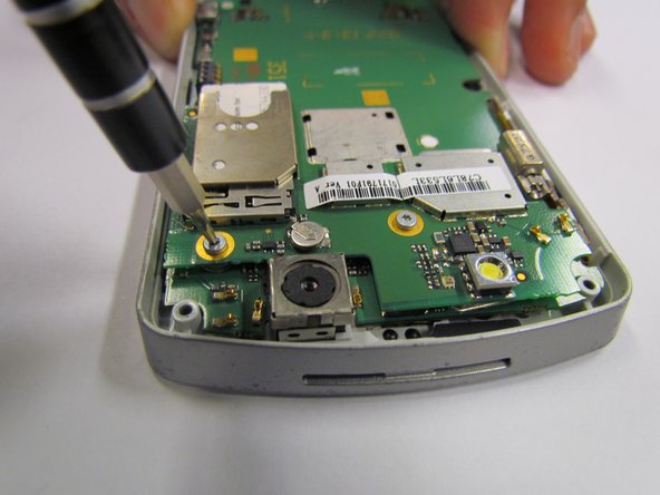

  7. Motorola Q Global Display screen Replacement: crwdns2935265:07crwdnd2935265:01crwdnd2935265:02crwdne2935265:0 Motorola Q Global Display screen Replacement: crwdns2935265:07crwdnd2935265:02crwdnd2935265:02crwdne2935265:0
    • Remove both screws on the mounted surface with a T5 screwdriver.

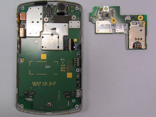

  8. Motorola Q Global Display screen Replacement: crwdns2935265:08crwdnd2935265:01crwdnd2935265:02crwdne2935265:0 Motorola Q Global Display screen Replacement: crwdns2935265:08crwdnd2935265:02crwdnd2935265:02crwdne2935265:0
    • Remove the glued, mounted surface by lifting it from underneath the SIM card slot by using the plastic opening tool.

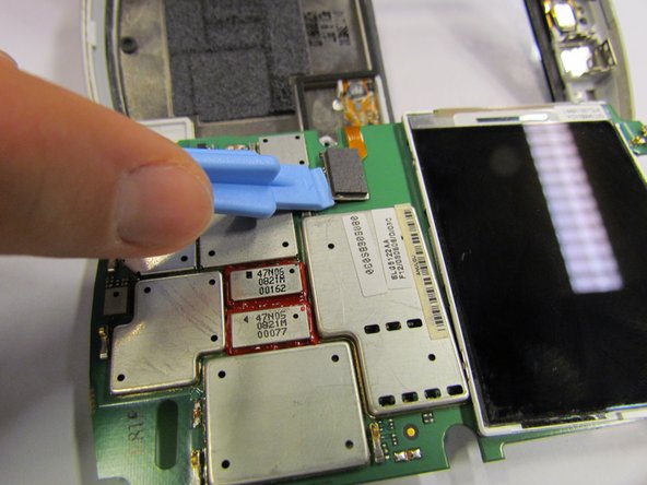

  9. Motorola Q Global Display screen Replacement: crwdns2935265:09crwdnd2935265:01crwdnd2935265:02crwdne2935265:0 Motorola Q Global Display screen Replacement: crwdns2935265:09crwdnd2935265:02crwdnd2935265:02crwdne2935265:0
    • Lift the motherboard about 90 degrees and remove the circuit with the orange ribbon (from the keyboard) by gently lifting the circuit.

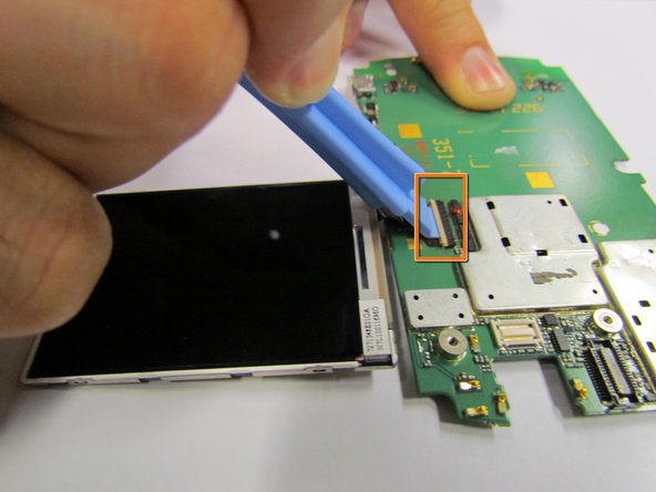

    • Separate the front plate from the circuit board.
    • The LCD screen is attached to the circuit board by a thin ribbon.
    • Switch the lock on top of the circuit entry from horizontal to vertical.
  11. Motorola Q Global Display screen Replacement: crwdns2935265:011crwdnd2935265:01crwdnd2935265:01crwdne2935265:0
    • Insert the new LCD screen into the circuit.
