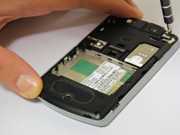

    • Remove the six labeled screws with a T5 Torx Screwdriver.
  6. Motorola Q Global Camera Replacement: crwdns2935265:06crwdnd2935265:01crwdnd2935265:01crwdne2935265:0
    • Once the screws are removed, use the plastic opening tool to remove the black casing.

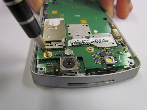

    • Remove both screws on the mounted surface with a T5 screwdriver.

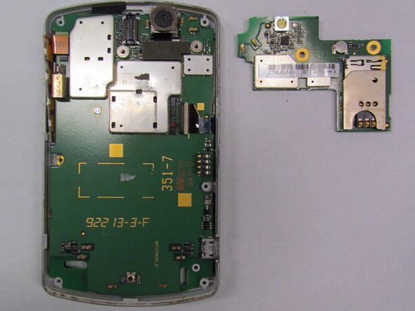

  8. Motorola Q Global Camera Replacement: crwdns2935265:08crwdnd2935265:01crwdnd2935265:02crwdne2935265:0 Motorola Q Global Camera Replacement: crwdns2935265:08crwdnd2935265:02crwdnd2935265:02crwdne2935265:0
    • Remove the glued, mounted surface by lifting it from underneath the SIM card slot by using the plastic opening tool.
  9. Motorola Q Global Camera Replacement: crwdns2935265:09crwdnd2935265:01crwdnd2935265:01crwdne2935265:0
    • Use the plastic opening tool to lift the camera from the phone.
  10. Motorola Q Global Camera Replacement: crwdns2935265:010crwdnd2935265:01crwdnd2935265:01crwdne2935265:0
    • The new camera can now be attached to the motherboard.
