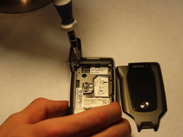

    • Remove back cover of the phone by disengaging the clip and lifting up on the cover.
  2. Motorola Nextel i880 Logic Board Replacement: crwdns2935265:02crwdnd2935265:01crwdnd2935265:02crwdne2935265:0 Motorola Nextel i880 Logic Board Replacement: crwdns2935265:02crwdnd2935265:02crwdnd2935265:02crwdne2935265:0
    • Remove screws 1 through 4.

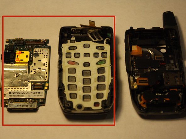

  3. Motorola Nextel i880 Logic Board Replacement: crwdns2935265:03crwdnd2935265:01crwdnd2935265:01crwdne2935265:0
    • Once all four screws are removed, you should be able to take off the back half of the phone.
  4. Motorola Nextel i880 Logic Board Replacement: crwdns2935265:04crwdnd2935265:01crwdnd2935265:01crwdne2935265:0

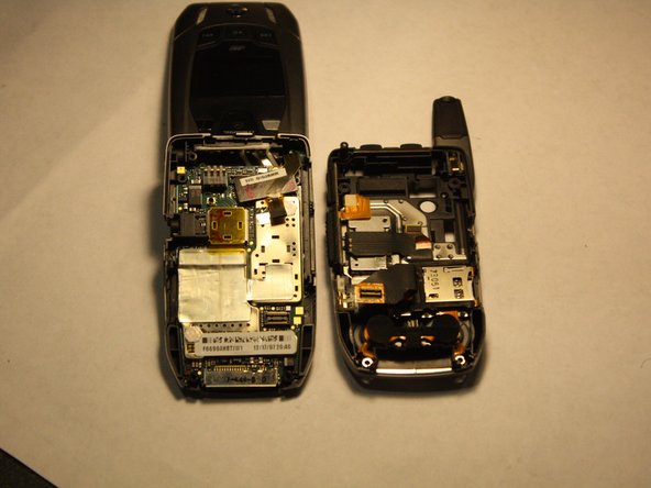

    • Remove the connection at the top right of the circuit board.
  5. Motorola Nextel i880 Logic Board Replacement: crwdns2935265:05crwdnd2935265:01crwdnd2935265:01crwdne2935265:0
    • Insert new logic board and reattach top right cable.
