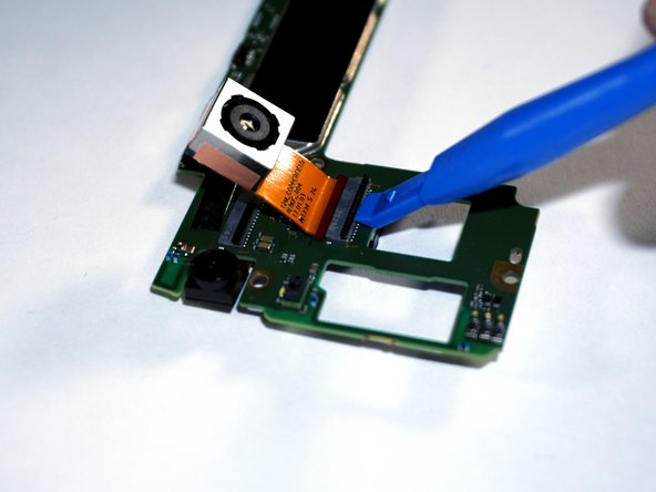

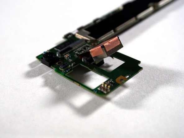

  26. Motorola Moto Z2 Play Rear Facing Camera Replacement, Rear-Facing Camera: crwdns2935265:026crwdnd2935265:01crwdnd2935265:03crwdne2935265:0 Motorola Moto Z2 Play Rear Facing Camera Replacement, Rear-Facing Camera: crwdns2935265:026crwdnd2935265:02crwdnd2935265:03crwdne2935265:0 Motorola Moto Z2 Play Rear Facing Camera Replacement, Rear-Facing Camera: crwdns2935265:026crwdnd2935265:03crwdnd2935265:03crwdne2935265:0
    • Flip over the motherboard so the rear-facing camera and its ribbon can be seen.
    • Bend the camera back to reveal its ribbon-wire port.
  27. Motorola Moto Z2 Play Rear Facing Camera Replacement: crwdns2935265:027crwdnd2935265:01crwdnd2935265:02crwdne2935265:0 Motorola Moto Z2 Play Rear Facing Camera Replacement: crwdns2935265:027crwdnd2935265:02crwdnd2935265:02crwdne2935265:0
    • Lift the locking bar on the ZIF connector that is under the rear facing camera with a plastic opening tool.
    • You can also use a spudger to complete this step.

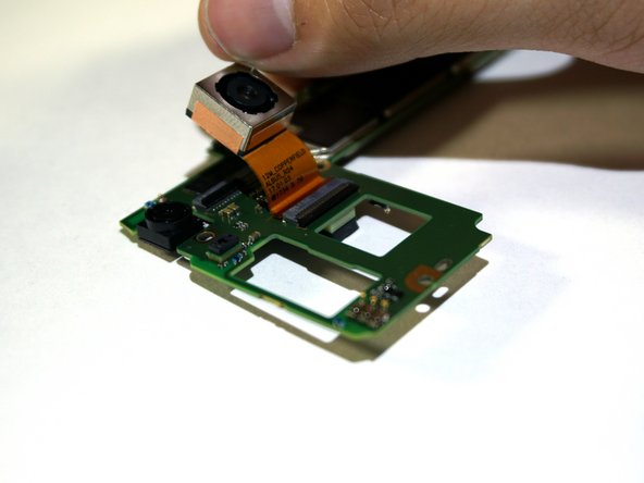

  28. Motorola Moto Z2 Play Rear Facing Camera Replacement: crwdns2935265:028crwdnd2935265:01crwdnd2935265:01crwdne2935265:0
    • Pull out the ribbon connector for the rear-facing camera.
