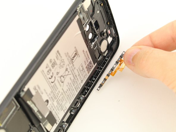

  29. Motorola Moto Z2 Force Power/Volume Button Replacement, Power/Volume Button: crwdns2935265:029crwdnd2935265:01crwdnd2935265:03crwdne2935265:0 Motorola Moto Z2 Force Power/Volume Button Replacement, Power/Volume Button: crwdns2935265:029crwdnd2935265:02crwdnd2935265:03crwdne2935265:0 Motorola Moto Z2 Force Power/Volume Button Replacement, Power/Volume Button: crwdns2935265:029crwdnd2935265:03crwdnd2935265:03crwdne2935265:0
    • Unscrew the three silver 1.7mm T4 screws from the inner rim of the case connecting the Power and Volume buttons.
    • Remove the button board.
