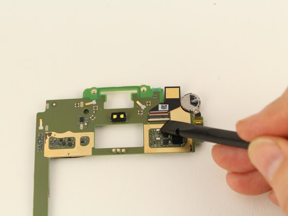

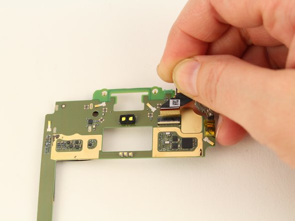

  29. Motorola Moto Z2 Force Front Facing Camera Replacement, Front Facing Camera: crwdns2935265:029crwdnd2935265:01crwdnd2935265:03crwdne2935265:0 Motorola Moto Z2 Force Front Facing Camera Replacement, Front Facing Camera: crwdns2935265:029crwdnd2935265:02crwdnd2935265:03crwdne2935265:0 Motorola Moto Z2 Force Front Facing Camera Replacement, Front Facing Camera: crwdns2935265:029crwdnd2935265:03crwdnd2935265:03crwdne2935265:0
    • Flip the motherboard over.
    • Use the black nylon spudger to lift the white bar of the ZIF connector in the upper right corner.
    • Pull the front facing camera out from the ZIF connector and away from the motherboard.
