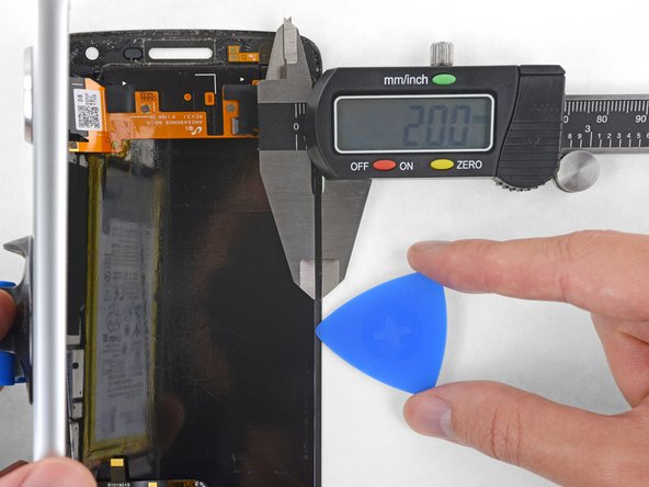

  3. Motorola Moto Z Play Speaker Replacement: crwdns2935265:03crwdnd2935265:01crwdnd2935265:03crwdne2935265:0 Motorola Moto Z Play Speaker Replacement: crwdns2935265:03crwdnd2935265:02crwdnd2935265:03crwdne2935265:0 Motorola Moto Z Play Speaker Replacement: crwdns2935265:03crwdnd2935265:03crwdnd2935265:03crwdne2935265:0
    • In the following steps, you will separate the display assembly from the Moto Z Play's chassis.
    • For reference, refer to the first image, showing the back of the display assembly (right) after it has been removed from the phone (left).
    • If you plan to re-use the display assembly, pay particular attention to the side edges. When slicing through the glue in this area, you must be careful to insert your tool less than 2 mm, or your tool will come in contact with the display panel and damage it.
    • Playing cards are a safer, but much slower, prying tool. The soft paper cards are less likely to damage the display panel, which is good news if you plan to reuse it.

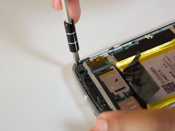

  21. Motorola Moto Z Play Speaker Replacement: crwdns2935265:021crwdnd2935265:01crwdnd2935265:03crwdne2935265:0 Motorola Moto Z Play Speaker Replacement: crwdns2935265:021crwdnd2935265:02crwdnd2935265:03crwdne2935265:0 Motorola Moto Z Play Speaker Replacement: crwdns2935265:021crwdnd2935265:03crwdnd2935265:03crwdne2935265:0
    • Remove the five 3 mm T3 screws from the black camera cover at the top of the phone.
    • Pry the camera cover up with your fingers to pop the camera cover clips loose.

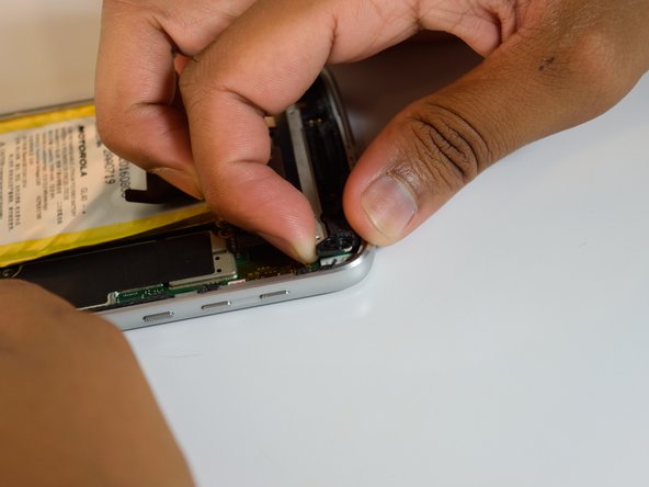

  22. Motorola Moto Z Play Speaker Replacement: crwdns2935265:022crwdnd2935265:01crwdnd2935265:01crwdne2935265:0
    • Pry the speaker unit from the camera cover with the smallest plastic opening tool.
