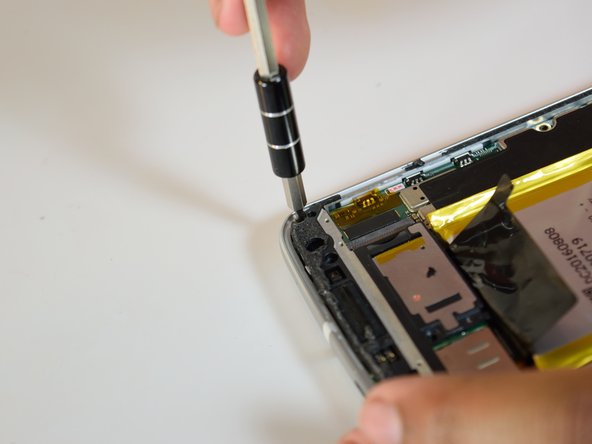

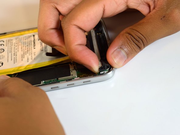

  21. Motorola Moto Z Play Rear Camera Replacement: crwdns2935265:021crwdnd2935265:01crwdnd2935265:03crwdne2935265:0 Motorola Moto Z Play Rear Camera Replacement: crwdns2935265:021crwdnd2935265:02crwdnd2935265:03crwdne2935265:0 Motorola Moto Z Play Rear Camera Replacement: crwdns2935265:021crwdnd2935265:03crwdnd2935265:03crwdne2935265:0
    • Remove the six 3mm T3 screws from the camera cover at the top of the phone.
    • Pry the camera cover up with your tools to pop the camera cover clips loose.

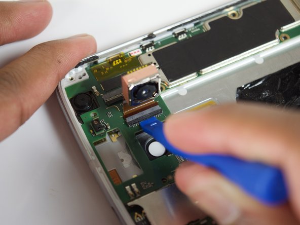

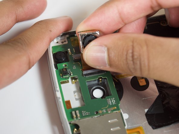

  22. Motorola Moto Z Play Rear Camera Replacement, Rear Camera: crwdns2935265:022crwdnd2935265:01crwdnd2935265:03crwdne2935265:0 Motorola Moto Z Play Rear Camera Replacement, Rear Camera: crwdns2935265:022crwdnd2935265:02crwdnd2935265:03crwdne2935265:0 Motorola Moto Z Play Rear Camera Replacement, Rear Camera: crwdns2935265:022crwdnd2935265:03crwdnd2935265:03crwdne2935265:0
    • Lift the locking bar on the ZIF connector for the rear facing camera and pull the ribbon cable loose.
    • The locking bar is the small black bar that runs across the ZIF connector.
