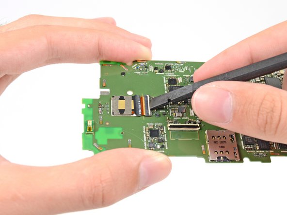

  28. Motorola Moto X Rear Facing Camera Replacement, Rear Facing Camera: crwdns2935265:028crwdnd2935265:01crwdnd2935265:03crwdne2935265:0 Motorola Moto X Rear Facing Camera Replacement, Rear Facing Camera: crwdns2935265:028crwdnd2935265:02crwdnd2935265:03crwdne2935265:0 Motorola Moto X Rear Facing Camera Replacement, Rear Facing Camera: crwdns2935265:028crwdnd2935265:03crwdnd2935265:03crwdne2935265:0
    • Use the flat end of a spudger to flip up the retaining tab on the rear-facing camera ZIF cable connector.
    • Remove the rear-facing camera from the motherboard.
