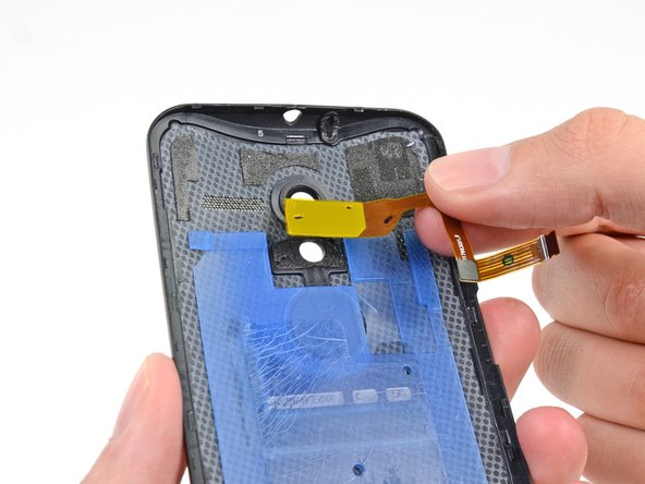

  11. Motorola Moto X Rear Facing Camera Flash Replacement, Back Cover: crwdns2935265:011crwdnd2935265:01crwdnd2935265:03crwdne2935265:0 Motorola Moto X Rear Facing Camera Flash Replacement, Back Cover: crwdns2935265:011crwdnd2935265:02crwdnd2935265:03crwdne2935265:0 Motorola Moto X Rear Facing Camera Flash Replacement, Back Cover: crwdns2935265:011crwdnd2935265:03crwdnd2935265:03crwdne2935265:0
    • Use the flat end of a spudger to gently pry between the flash assembly and back cover to separate the adhesive.
    • Remove the flash assembly from the back cover.
    • You may also need to transfer the camera lens and the silicon pad from the rear case. These can be removed by prying carefully with a plastic opening tool.
    • Depending on the adhesive on the rear case, you may need to tape the flash assembly down to secure it.
