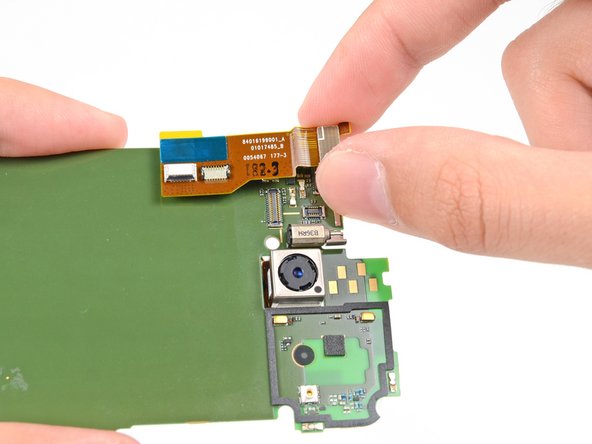

  28. Motorola Moto X Motherboard Replacement, Motherboard: crwdns2935265:028crwdnd2935265:01crwdnd2935265:02crwdne2935265:0 Motorola Moto X Motherboard Replacement, Motherboard: crwdns2935265:028crwdnd2935265:02crwdnd2935265:02crwdne2935265:0
    • Use the flat end of a spudger to free the interconnect cable connector.
    • Remove the interconnect cable from the motherboard.

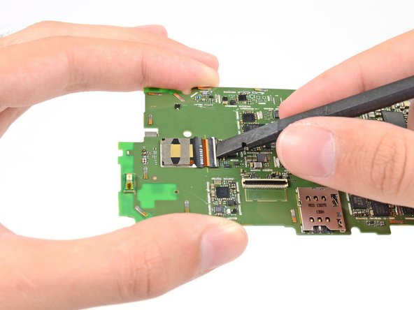

  29. Motorola Moto X Motherboard Replacement: crwdns2935265:029crwdnd2935265:01crwdnd2935265:03crwdne2935265:0 Motorola Moto X Motherboard Replacement: crwdns2935265:029crwdnd2935265:02crwdnd2935265:03crwdne2935265:0 Motorola Moto X Motherboard Replacement: crwdns2935265:029crwdnd2935265:03crwdnd2935265:03crwdne2935265:0
    • Use the flat end of a spudger to flip up the retaining tab on the front-facing camera ZIF cable connector.
    • Remove the front-facing camera from the motherboard.
