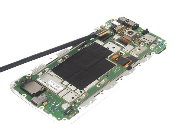

  9. Motorola Moto X 2nd Generation Screen Replacement: crwdns2935265:09crwdnd2935265:01crwdnd2935265:02crwdne2935265:0 Motorola Moto X 2nd Generation Screen Replacement: crwdns2935265:09crwdnd2935265:02crwdnd2935265:02crwdne2935265:0
    • Pry up the motherboard from right and bottom corner. Remove the LCD screen from motherboard.
  10. Motorola Moto X 2nd Generation Screen Replacement: crwdns2935265:010crwdnd2935265:01crwdnd2935265:01crwdne2935265:0
    • Tips: The LCD screen is difficult to separate from bezel even though by heat. So you'd better prepare the screen replacement parts with bezel together. And the metal shield can be removed easily.

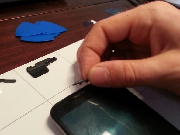

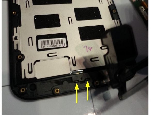

  11. Motorola Moto X 2nd Generation Screen Replacement, Remove the Speaker Grills from the Broken Screen: crwdns2935265:011crwdnd2935265:01crwdnd2935265:03crwdne2935265:0 Motorola Moto X 2nd Generation Screen Replacement, Remove the Speaker Grills from the Broken Screen: crwdns2935265:011crwdnd2935265:02crwdnd2935265:03crwdne2935265:0 Motorola Moto X 2nd Generation Screen Replacement, Remove the Speaker Grills from the Broken Screen: crwdns2935265:011crwdnd2935265:03crwdnd2935265:03crwdne2935265:0
    • The newly purchased screen will likely not have speaker grills so you must remove them from the broken screen and put them onto the new screen
    • On both the upper and lower speakers remove the speaker foam that is adhered lightly. Peel away gently. This foam will not be reused so its ok if it gets torn.
    • Locate the two tabs that holds the speaker grill in place. Highlighted in photo with yellow arrows.
    • Push out the speaker grill by forcing either one of those two tabs out of the frame by pushing onto the tab with a tweezer end. It requires a bit of force and it will pop out.
    • The photo only show the lower speaker grill removal, but the upper speaker grill is removed in the same manner.

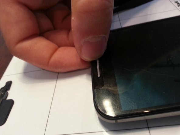

  12. Motorola Moto X 2nd Generation Screen Replacement, Putting Old Speaker Grill Into New Screen: crwdns2935265:012crwdnd2935265:01crwdnd2935265:03crwdne2935265:0 Motorola Moto X 2nd Generation Screen Replacement, Putting Old Speaker Grill Into New Screen: crwdns2935265:012crwdnd2935265:02crwdnd2935265:03crwdne2935265:0 Motorola Moto X 2nd Generation Screen Replacement, Putting Old Speaker Grill Into New Screen: crwdns2935265:012crwdnd2935265:03crwdnd2935265:03crwdne2935265:0
    • After removal of both speaker grills they can be put into the new screen. Wait until the phone is fully reassembled to put the old grills into the new screen.
    • Align the two tabs of the grill with the two slots in the new screen
    • Carefully push the grill into the two slots. Start by pushing with your thumb and nail over one tab and only push one of the two tabs in at a time. A lot of pushing pressure is required so be careful not to damage the new screen.
    • If you are unable to push the grills in with your thumbs, try placing the grills in position and then pushing the screen face-down against a flat surface.
    • After one of the tabs is into the slot then the second tab can be pushed into the slot with some additional pressure. Both speaker grills can be replaced in this manner.
    • A couple people reported breaking their newly installed screen while popping in the speaker grill. Its also OK to not even install the cosmetic speaker grill.
