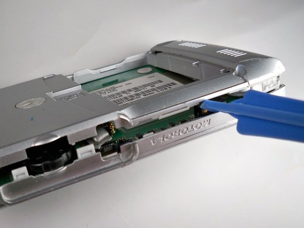

    • Wedge the plastic opening tool in between the top and bottom cases. This may require a little or a lot of force so be careful.
    • Note: the phone should be face up and the plastic opening tool should be face downwards
    • Once you get the plastic opening tool in, slide it across the side of the phone, making sure to keep the plastic opening tool wedged in between the two casings.
    • Repeat the 3 steps above for the top, bottom, and opposite side.

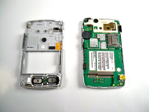

  4. Motorola Moto Q LCD Display Replacment: crwdns2935265:04crwdnd2935265:01crwdnd2935265:02crwdne2935265:0 Motorola Moto Q LCD Display Replacment: crwdns2935265:04crwdnd2935265:02crwdnd2935265:02crwdne2935265:0
    • Gently lift and remove the back casing.

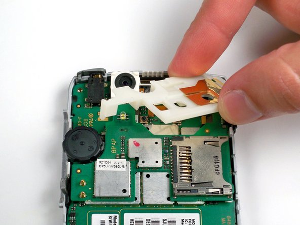

  6. Motorola Moto Q LCD Display Replacment: crwdns2935265:06crwdnd2935265:01crwdnd2935265:02crwdne2935265:0 Motorola Moto Q LCD Display Replacment: crwdns2935265:06crwdnd2935265:02crwdnd2935265:02crwdne2935265:0
    • Using your fingers, remove the plastic piece that holds the camera in place.

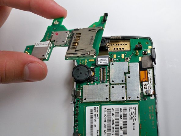

  7. Motorola Moto Q LCD Display Replacment: crwdns2935265:07crwdnd2935265:01crwdnd2935265:02crwdne2935265:0 Motorola Moto Q LCD Display Replacment: crwdns2935265:07crwdnd2935265:02crwdnd2935265:02crwdne2935265:0
    • Carefully pry up the upper circuit board with the spudger.
    • The second picture shows what your phone should look like when the upper circuit board is removed.

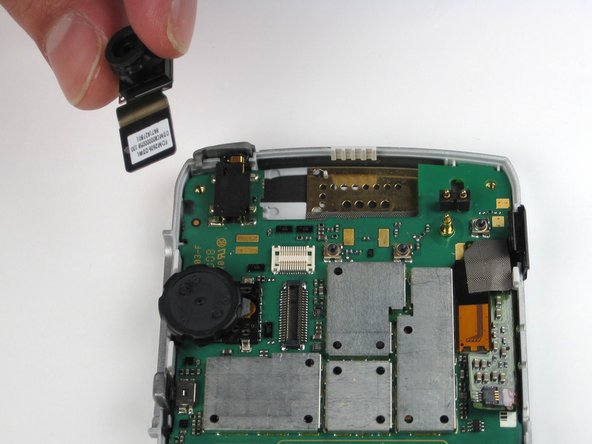

    • Take out the camera and attached chip with the iPod removal tool. Carefully pry the chip off its connection and the camera will come out too.

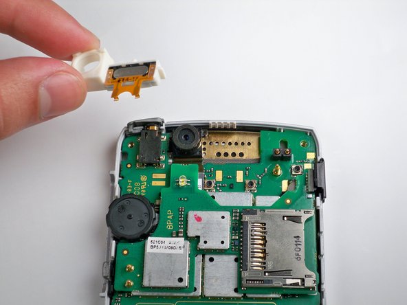

    • Remove the infra red plastic covering,the button on the left side of the phone, and the earphone cover lid by pulling straight up on them with your fingers.

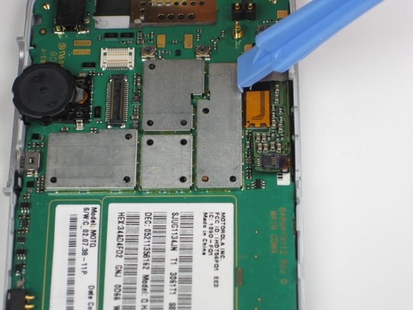

    • Wedge the plastic opening tool in between the logic board and the small orange band and gently pry upwards.
    • Note: the orange band is connected to the logic board by a small connector.

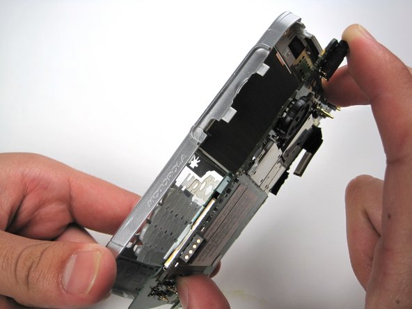

  10. Motorola Moto Q LCD Display Replacment: crwdns2935265:010crwdnd2935265:01crwdnd2935265:03crwdne2935265:0 Motorola Moto Q LCD Display Replacment: crwdns2935265:010crwdnd2935265:02crwdnd2935265:03crwdne2935265:0 Motorola Moto Q LCD Display Replacment: crwdns2935265:010crwdnd2935265:03crwdnd2935265:03crwdne2935265:0
    • Wedge the spudger in between the logic board and the front casing and gently lift while pulling away from the orange ribbon.
    • Note: it is easier to remove the logic board by prying upwards near the top of left corner phone.

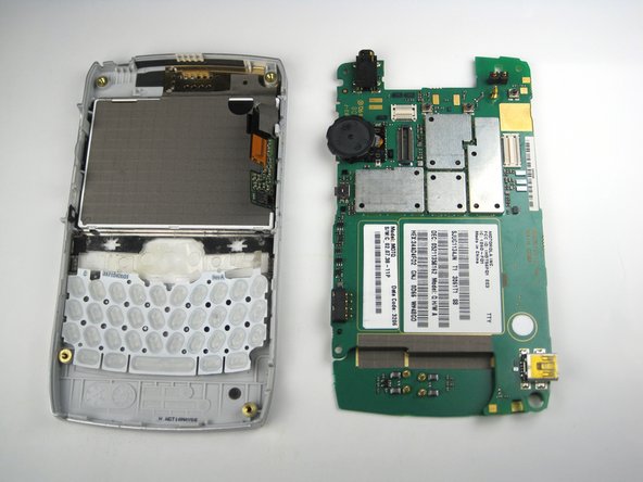

  11. Motorola Moto Q LCD Display Replacment: crwdns2935265:011crwdnd2935265:01crwdnd2935265:03crwdne2935265:0 Motorola Moto Q LCD Display Replacment: crwdns2935265:011crwdnd2935265:02crwdnd2935265:03crwdne2935265:0 Motorola Moto Q LCD Display Replacment: crwdns2935265:011crwdnd2935265:03crwdnd2935265:03crwdne2935265:0

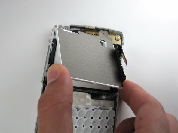

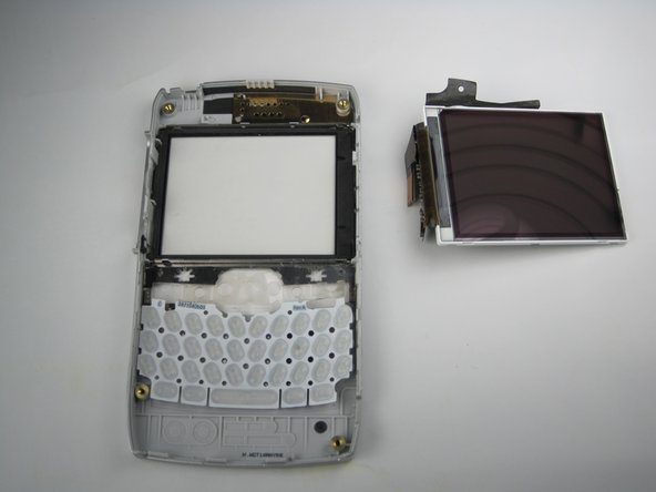

    • Wedge the plastic opening tool between the LCD screen and the metal casing holding it in and lift gently.
    • Note: the LCD screen is also held in place by a silver tape. Simply pull the screen from one side to other to remove the screen completely.
