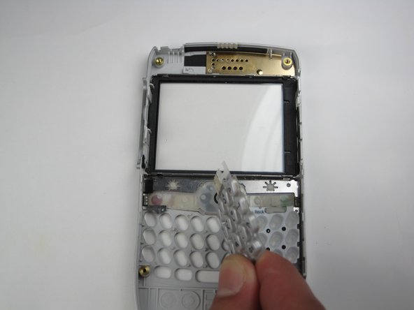

  12. Motorola Moto Q Front Casing Replacement, Keyboard: crwdns2935265:012crwdnd2935265:01crwdnd2935265:03crwdne2935265:0 Motorola Moto Q Front Casing Replacement, Keyboard: crwdns2935265:012crwdnd2935265:02crwdnd2935265:03crwdne2935265:0 Motorola Moto Q Front Casing Replacement, Keyboard: crwdns2935265:012crwdnd2935265:03crwdnd2935265:03crwdne2935265:0
    • The keyboard is held in place with a little bit of glue.
    • Simply lift the keyboard buttons with your hands pulling from one side to the other.
  13. Motorola Moto Q Front Casing Replacement, Front Casing: crwdns2935265:013crwdnd2935265:01crwdnd2935265:01crwdne2935265:0
    • Remove the navigation buttons by pushing them with your finger(s) until they come loose.
    • Now simply peel the buttons off.
    • The buttons are held in place by glue. it may require a little extra pull to take off the buttons.
