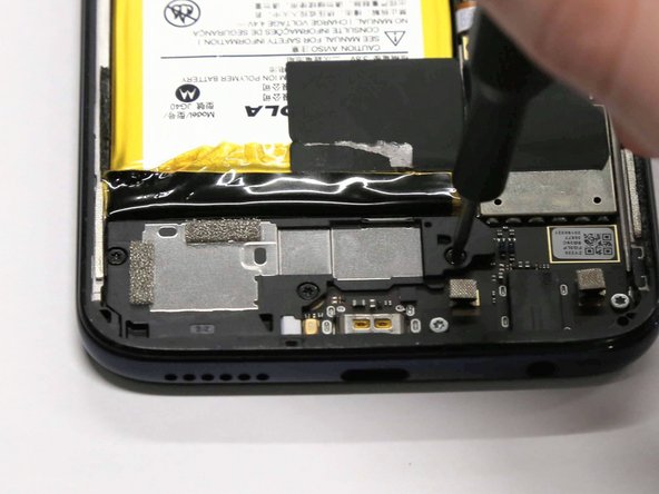

  9. Motorola Moto G7 Plus  Rear Camera Replacement: crwdns2935265:09crwdnd2935265:01crwdnd2935265:03crwdne2935265:0 Motorola Moto G7 Plus  Rear Camera Replacement: crwdns2935265:09crwdnd2935265:02crwdnd2935265:03crwdne2935265:0 Motorola Moto G7 Plus  Rear Camera Replacement: crwdns2935265:09crwdnd2935265:03crwdnd2935265:03crwdne2935265:0
    • Use a Torx T5 screwdriver to remove the six 2.7mm screws and one 3.0mm screw.
    • Remove the plate from the phone.
  10. Motorola Moto G7 Plus  Rear Camera Replacement: crwdns2935265:010crwdnd2935265:01crwdnd2935265:01crwdne2935265:0
    • Use a spudger to disconnect the bands.

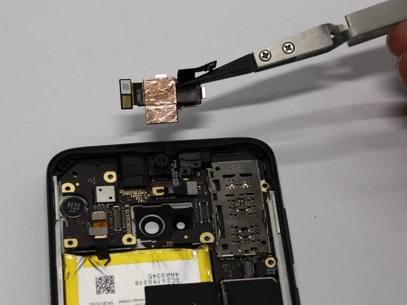

  11. Motorola Moto G7 Plus  Rear Camera Replacement: crwdns2935265:011crwdnd2935265:01crwdnd2935265:02crwdne2935265:0 Motorola Moto G7 Plus  Rear Camera Replacement: crwdns2935265:011crwdnd2935265:02crwdnd2935265:02crwdne2935265:0
    • Gently lift up the piece either with your fingers or a spudger.
    • Use the reverse tweezers to gently remove the piece from underneath.
