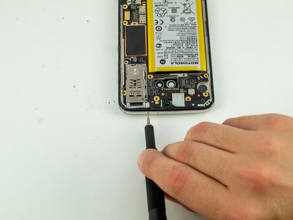

    • Use the iFixit opening tools to gently wedge the front screen from the rest of the device.
    • Try to focus on the corners to make it easier to insert and use the iFixit opening picks.
    • It is also recommended to use the iOpener or a heat gun to weaken the adhesive that holds the edges of the screen down.
    • The screen is glass, so when using force to lift the screen, be cautious of cracked glass and stray shards of glass coming off.
    • You have to be extra careful to dig deep enough, so you lift the entire screen unit!

    • Remove three 2.7mm T3 Torx screws from the metal piece to the right of the battery.
  4. Motorola Moto G7 Battery Replacement: crwdns2935265:04crwdnd2935265:01crwdnd2935265:03crwdne2935265:0 Motorola Moto G7 Battery Replacement: crwdns2935265:04crwdnd2935265:02crwdnd2935265:03crwdne2935265:0 Motorola Moto G7 Battery Replacement: crwdns2935265:04crwdnd2935265:03crwdnd2935265:03crwdne2935265:0
    • Use a spudger to gently take off the metal piece that was held down by the screws.
    • A second metal piece is held under the first. This can also be popped off by using the spudger and nudging it under the metal piece connected to the band.

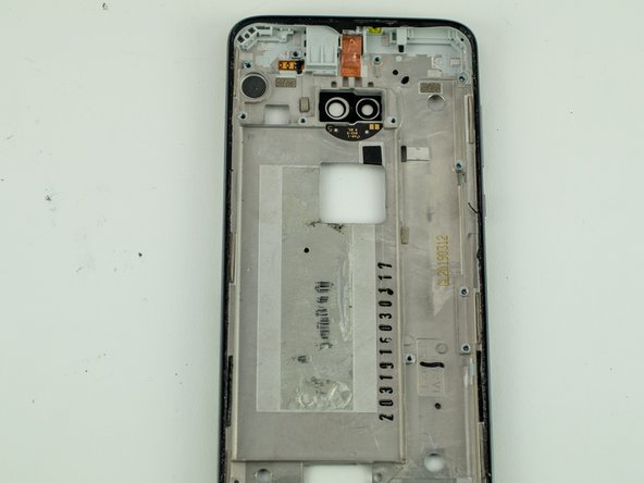

    • Use a T3 Torx screwdriver to remove the four 2.3mm screws from the bottom and right sides of the phone.
  11. Motorola Moto G7 Battery Replacement: crwdns2935265:011crwdnd2935265:01crwdnd2935265:02crwdne2935265:0 Motorola Moto G7 Battery Replacement: crwdns2935265:011crwdnd2935265:02crwdnd2935265:02crwdne2935265:0
    • Lever the spudger underneath the motherboard above the battery.
    • Use a medium amount of force to remove the motherboard from the rest of the phone assembly.

I don’t know what phone you are replacing a battery on here, but it looks nothing like my Motorola G7, which has a JK50 battery in it. The JK50 is NOT interchangeable with the JG30 you have pictured here and available to order.
Jeanette Carey - crwdns2934203:0crwdne2934203:0
The Moto G7 has many variations, including the G7 Play and the G7 Power, which is the model that takes the JK50. These instructions are for the plain vanilla G7.
Jim Grybowski -
This is a careless incomplete guide. It skips crucial steps, like removing the speaker subassembly (which the photos clearly show was done but not even mentioned), the buttons connector, and last but not least the battery connector itself. I also have wound up with two mystery rubberized parts which fell out at two separate points in disassembly, which are also never mentioned and which I will now have to black-box to figure out where they came from.
Vulcan Tourist - crwdns2934203:0crwdne2934203:0
It also glosses over the reassembly, omitting it entirely in fact, thus failing to remind the reader, for instance, not to overlook the fingerprint reader’s connector when reinserting the motherboard and paying heed of the several tabs - and rubber parts which must be considered when reattaching that metal shield over the camera.
