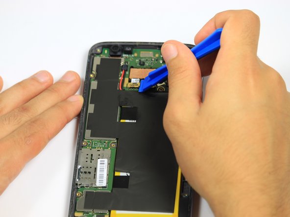

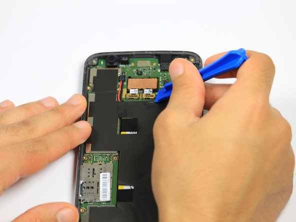

  7. Motorola Moto G5s Plus Rear Camera Replacement: crwdns2935265:07crwdnd2935265:01crwdnd2935265:02crwdne2935265:0 Motorola Moto G5s Plus Rear Camera Replacement: crwdns2935265:07crwdnd2935265:02crwdnd2935265:02crwdne2935265:0
    • Disengage the two cable connectors by gently prying beneath the edge of the connector with the opening tool.
  8. Motorola Moto G5s Plus Rear Camera Replacement: crwdns2935265:08crwdnd2935265:01crwdnd2935265:02crwdne2935265:0 Motorola Moto G5s Plus Rear Camera Replacement: crwdns2935265:08crwdnd2935265:02crwdnd2935265:02crwdne2935265:0
    • Lift up the detached right connector from its housing using blunt tweezers.
    • The housing has light adhesive underneath it. Use a small amount of force to remove the connector from the housing.
