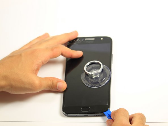

    • Power off the phone before you begin.
    • Bring the heat gun one to two inches from the edges of the display to melt the display adhesive.
    • Spend equal amounts of time applying heat around the entire edge of the phone.
  2. Motorola Moto G5s Plus Battery Replacement: crwdns2935265:02crwdnd2935265:01crwdnd2935265:02crwdne2935265:0 Motorola Moto G5s Plus Battery Replacement: crwdns2935265:02crwdnd2935265:02crwdnd2935265:02crwdne2935265:0
    • Attach the suction cup to the display slightly to the left of center.
    • Exert a moderate force to pull on the suction cup. The display will come loose.

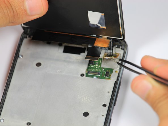

  4. Motorola Moto G5s Plus Battery Replacement: crwdns2935265:04crwdnd2935265:01crwdnd2935265:03crwdne2935265:0 Motorola Moto G5s Plus Battery Replacement: crwdns2935265:04crwdnd2935265:02crwdnd2935265:03crwdne2935265:0 Motorola Moto G5s Plus Battery Replacement: crwdns2935265:04crwdnd2935265:03crwdnd2935265:03crwdne2935265:0
    • The display should now be entirely loose, attached only by the connectors at the top of the device and the fingerprint sensor connector at the bottom of the device.
    • Press down on the fingerprint sensor with the display slightly raised to disconnect it from the display.
    • If the fingerprint sensor does not come loose, use the heat gun to loosen its adhesive.

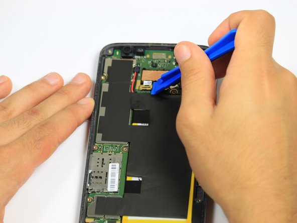

    • Use the opening tool to remove the two metal connectors located above the battery.
    • Apply a gentle upward pressure to loosen the metal plates.

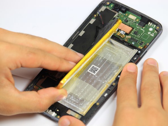

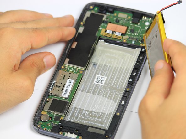

  18. Motorola Moto G5s Plus Battery Replacement: crwdns2935265:018crwdnd2935265:01crwdnd2935265:03crwdne2935265:0 Motorola Moto G5s Plus Battery Replacement: crwdns2935265:018crwdnd2935265:02crwdnd2935265:03crwdne2935265:0 Motorola Moto G5s Plus Battery Replacement: crwdns2935265:018crwdnd2935265:03crwdnd2935265:03crwdne2935265:0
    • Insert the spudger underneath the right side of the battery.
    • Apply a moderate upward force along the length of battery, until the battery lifts out of place.
    • Remove the battery with your hand.
