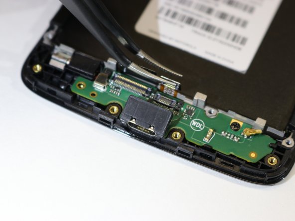

  9. Motorola Moto G5 Vibration Motor Replacement: crwdns2935265:09crwdnd2935265:01crwdnd2935265:03crwdne2935265:0 Motorola Moto G5 Vibration Motor Replacement: crwdns2935265:09crwdnd2935265:02crwdnd2935265:03crwdne2935265:0 Motorola Moto G5 Vibration Motor Replacement: crwdns2935265:09crwdnd2935265:03crwdnd2935265:03crwdne2935265:0
    • Remove the three connectors on the board below the battery slow by gently pulling on the small gold tab with a pair of tweezers.
  10. Motorola Moto G5 Vibration Motor Replacement: crwdns2935265:010crwdnd2935265:01crwdnd2935265:01crwdne2935265:0
    • Remove the 3.4 mm Philips screw securing the daughterboard to the frame.
  11. Motorola Moto G5 Vibration Motor Replacement: crwdns2935265:011crwdnd2935265:01crwdnd2935265:01crwdne2935265:0
    • Use the point of a spudger to lift the vibration motor connector up out of the socket on the I/O board.
    • Be very careful to pry only on the connector under the red and black cables, not on the socket itself.
