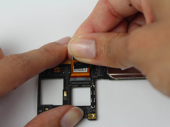

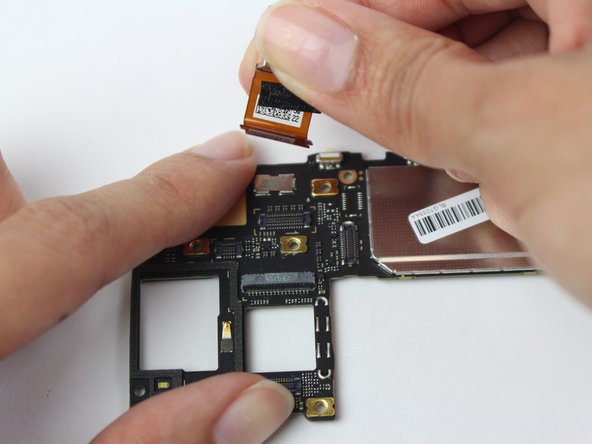

  27. Motorola Moto G5 Plus Rear Facing Camera Replacement, Rear Facing Camera: crwdns2935265:027crwdnd2935265:01crwdnd2935265:01crwdne2935265:0
    • The rear facing camera is in the upper center of the phone, with a gold covered back.
    • Gently pry the 12-megapixel G5 Plus rear-facing camera up using the plastic opening tool, exposing the ZIF connector.
  28. Motorola Moto G5 Plus Rear Facing Camera Replacement: crwdns2935265:028crwdnd2935265:01crwdnd2935265:03crwdne2935265:0 Motorola Moto G5 Plus Rear Facing Camera Replacement: crwdns2935265:028crwdnd2935265:02crwdnd2935265:03crwdne2935265:0 Motorola Moto G5 Plus Rear Facing Camera Replacement: crwdns2935265:028crwdnd2935265:03crwdnd2935265:03crwdne2935265:0
    • Release the ZIF connector and remove the camera from the board.
