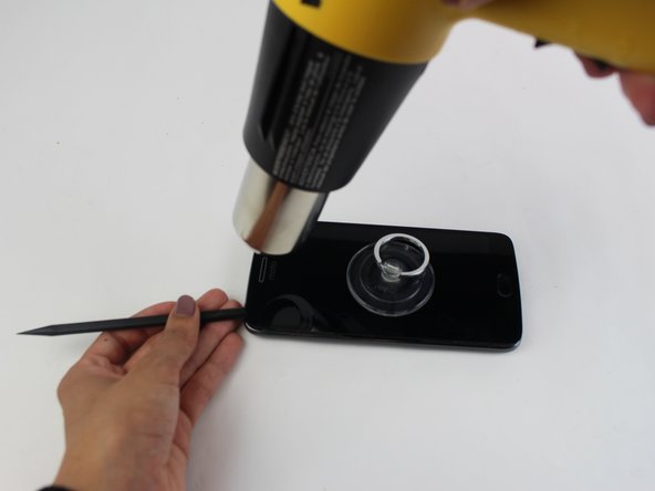

    • The screen is likely to crack as you pry it up. You should not complete this step unless you have a replacement screen available.
    • Stick the small suction cup onto the screen. Use this to remove the screen from the phone frame in later steps.
    • Using a heat gun on a low setting, slowly raise the temperature of the screen by repeatedly running the heat gun along the edges of the screen. This will soften the glue that holds the screen to the phone frame.
    • Use the suction cup to gently pull up on the screen while using the plastic opening tool to gently pry the edges of the screen up.
    • Once the screen has been completely separated from the phone frame, flip it to one side to expose the inside of the phone.

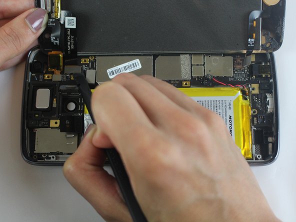

  7. Motorola Moto G5 Plus Motherboard Disassembly: crwdns2935265:07crwdnd2935265:01crwdnd2935265:01crwdne2935265:0
    • Unplug the battery by lifting up on the black plug with the plastic opening tool. This will shut off any power to the phone and prevent further damage.
    • Be careful not to damage the motherboard underneath the plugs.
  8. Motorola Moto G5 Plus Motherboard Disassembly: crwdns2935265:08crwdnd2935265:01crwdnd2935265:03crwdne2935265:0 Motorola Moto G5 Plus Motherboard Disassembly: crwdns2935265:08crwdnd2935265:02crwdnd2935265:03crwdne2935265:0 Motorola Moto G5 Plus Motherboard Disassembly: crwdns2935265:08crwdnd2935265:03crwdnd2935265:03crwdne2935265:0
    • Remove the 3 flat-topped connectors that connect the screen to the phone frame by prying them up with the plastic opening tool.
    • Fully detach the screen and set it to the side.
