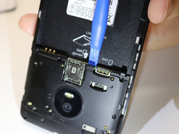

    • Insert your fingernail or the flat end of the spudger into the notch below the battery.
    • Pry with your fingernail or spudger until you free the battery from its recess.

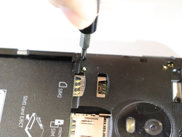

    • Remove the eight (8) 4mm screws with a Phillips screwdriver.

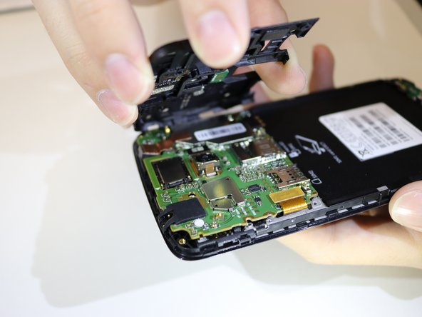

    • Pry the top motherboard cover off using a plastic opening tool.
    • When prying it open, make sure to pry it around evenly so that the cover will not snap. This will require some force.

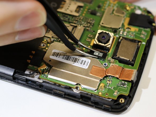

    • Disconnect the marked connector with a pair of tweezers and remove the camera piece.
