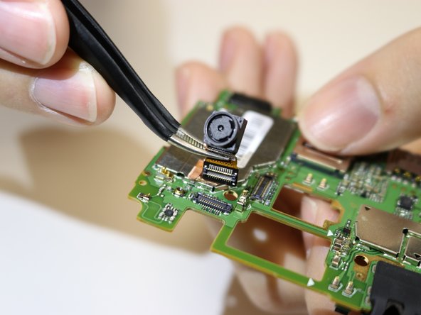

  13. Motorola Moto G5 Front Camera Replacement, Front Camera: crwdns2935265:013crwdnd2935265:01crwdnd2935265:02crwdne2935265:0 Motorola Moto G5 Front Camera Replacement, Front Camera: crwdns2935265:013crwdnd2935265:02crwdnd2935265:02crwdne2935265:0
    • Grab the connector with the tweezers and gently unplug the front camera from the motherboard.
