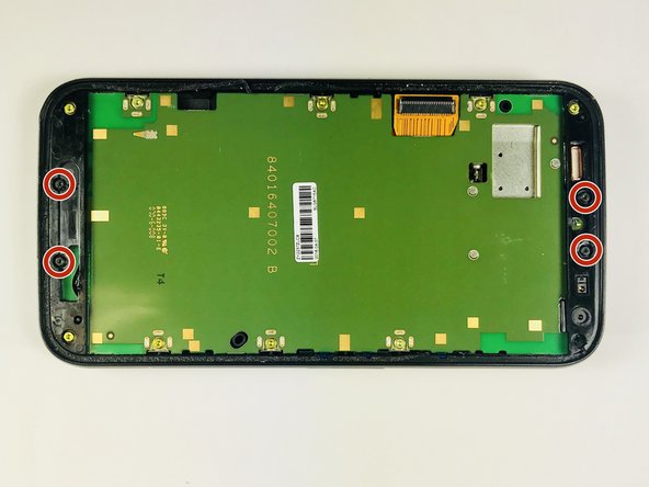

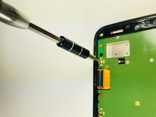

  5. Motorola Moto G3 Motherboard  Replacement, Motherboard: crwdns2935265:05crwdnd2935265:01crwdnd2935265:03crwdne2935265:0 Motorola Moto G3 Motherboard  Replacement, Motherboard: crwdns2935265:05crwdnd2935265:02crwdnd2935265:03crwdne2935265:0 Motorola Moto G3 Motherboard  Replacement, Motherboard: crwdns2935265:05crwdnd2935265:03crwdnd2935265:03crwdne2935265:0
    • With a T4 screwdriver, remove the10 "yellow" 2mm screws and 4 "black" 2mm screws.

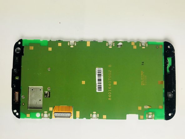

  6. Motorola Moto G3 Motherboard  Replacement: crwdns2935265:06crwdnd2935265:01crwdnd2935265:02crwdne2935265:0 Motorola Moto G3 Motherboard  Replacement: crwdns2935265:06crwdnd2935265:02crwdnd2935265:02crwdne2935265:0
    • Use the metal spudger and lift the back cover on the bottom side of the phone (this is attached to the motherboard).
    • Remove the motherboard from the device.
