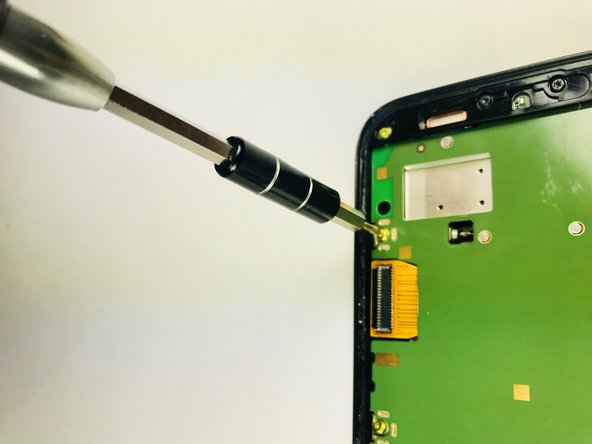

    • A strip will be attached to the motherboard as shown.
    • Using tweezers, carefully detach the strip from the motherboard.

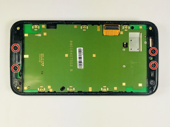

  5. Motorola Moto G3 Battery Replacement, Battery: crwdns2935265:05crwdnd2935265:01crwdnd2935265:03crwdne2935265:0 Motorola Moto G3 Battery Replacement, Battery: crwdns2935265:05crwdnd2935265:02crwdnd2935265:03crwdne2935265:0 Motorola Moto G3 Battery Replacement, Battery: crwdns2935265:05crwdnd2935265:03crwdnd2935265:03crwdne2935265:0
    • With a T4 screwdriver, remove the 10 "yellow" 2mm screws and 4 "black" 2mm screws.

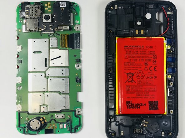

    • Use the metal spudger and lift the back cover on the bottom side of the phone (this is attached to the motherboard).

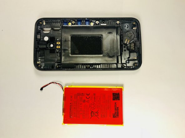

  7. Motorola Moto G3 Battery Replacement: crwdns2935265:07crwdnd2935265:01crwdnd2935265:01crwdne2935265:0
    • Remove the red and black battery cable from its port using tweezers.
  8. Motorola Moto G3 Battery Replacement: crwdns2935265:08crwdnd2935265:01crwdnd2935265:02crwdne2935265:0 Motorola Moto G3 Battery Replacement: crwdns2935265:08crwdnd2935265:02crwdnd2935265:02crwdne2935265:0
    • Use the same tweezers to remove the red battery from where it is placed.
