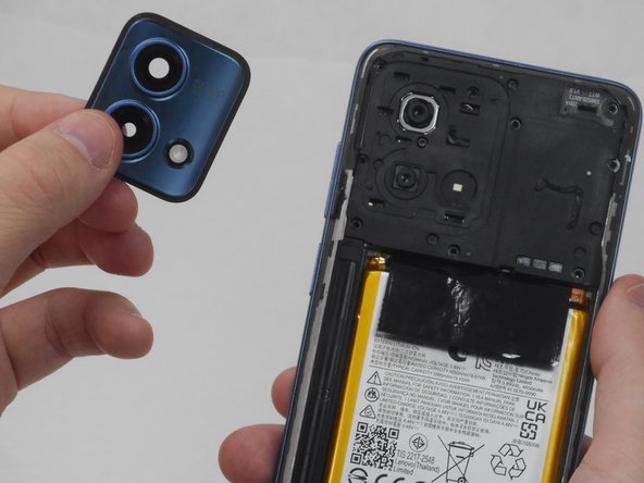

  3. Motorola Moto G Stylus 4G (2023) Screen Replacement: crwdns2935265:03crwdnd2935265:01crwdnd2935265:02crwdne2935265:0 Motorola Moto G Stylus 4G (2023) Screen Replacement: crwdns2935265:03crwdnd2935265:02crwdnd2935265:02crwdne2935265:0
    • Use the opening pick along the edges to separate the camera lens glass from the board. If you begin to pry where the picture indicates, you will only get the top plastic and it will peal away from the paint. Instead begin at the gap in the lower left hand corner where there is a space between the actual frame that contains the lenses and the phone.

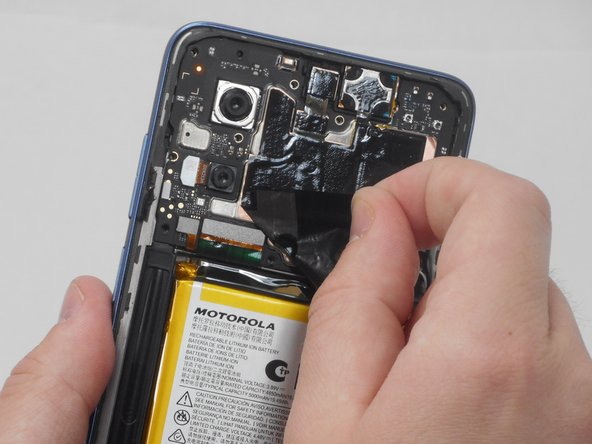

  6. Motorola Moto G Stylus 4G (2023) Screen Replacement: crwdns2935265:06crwdnd2935265:01crwdnd2935265:02crwdne2935265:0 Motorola Moto G Stylus 4G (2023) Screen Replacement: crwdns2935265:06crwdnd2935265:02crwdnd2935265:02crwdne2935265:0
    • Pull the black tab off of the battery gently with your hand.

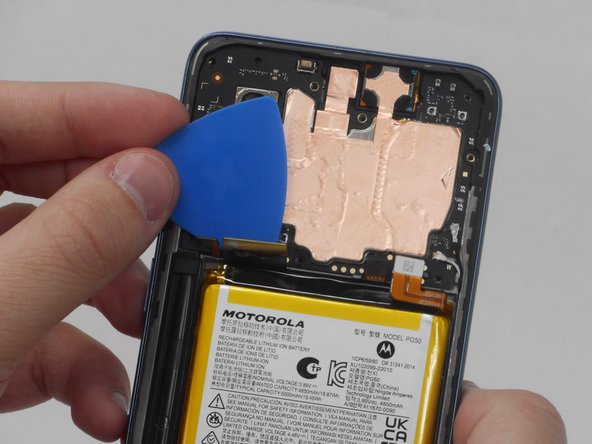

  7. Motorola Moto G Stylus 4G (2023) Screen Replacement: crwdns2935265:07crwdnd2935265:01crwdnd2935265:02crwdne2935265:0 Motorola Moto G Stylus 4G (2023) Screen Replacement: crwdns2935265:07crwdnd2935265:02crwdnd2935265:02crwdne2935265:0
    • Disconnect the four cables by inserting the opening pick beneath the edge of each.

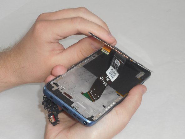

  11. Motorola Moto G Stylus 4G (2023) Screen Replacement: crwdns2935265:011crwdnd2935265:01crwdnd2935265:01crwdne2935265:0
    • Use a spudger to disconnect the screen connectors from the motherboard.
    • Remove any screws that are holding the screen in place.
  12. Motorola Moto G Stylus 4G (2023) Screen Replacement: crwdns2935265:012crwdnd2935265:01crwdnd2935265:01crwdne2935265:0
    • Remove the screen from the phone.
    • Clean the frame of any adhesive residue or glass shards.
    • Align the new screen to check its fit to the frame. Place the new screen with new adhesive.
