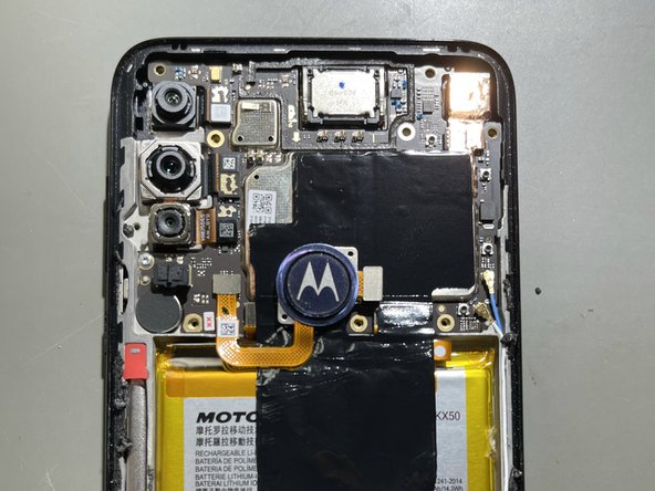

    • Make sure the phone is powered off.
    • Apply heat to the back of the phone to loosen the adhesive. We use a blue heat mat but the heated iOpener works as well.
  2. Motorola Moto G Stylus (2020) Charging Port Board Replacement: crwdns2935265:02crwdnd2935265:01crwdnd2935265:03crwdne2935265:0 Motorola Moto G Stylus (2020) Charging Port Board Replacement: crwdns2935265:02crwdnd2935265:02crwdnd2935265:03crwdne2935265:0 Motorola Moto G Stylus (2020) Charging Port Board Replacement: crwdns2935265:02crwdnd2935265:03crwdnd2935265:03crwdne2935265:0
    Plastic Cards
    $2.99
    • Start along the long edge of the phone and work a strong plastic card or opening pick underneath the back panel. A suction cup can be used to provide a little spacing to make it easier.
    • Carefully work the plastic card or pick along the edges of the phone. I recommend wearing gloves because the edge of the back panel are sharp and can cut a finger.
    • Apply pressure to the fingerprint reader while lifting slightly on the back panel. Once the adhesive starts to break loose you can use the plastic card to separate it from the back panel.

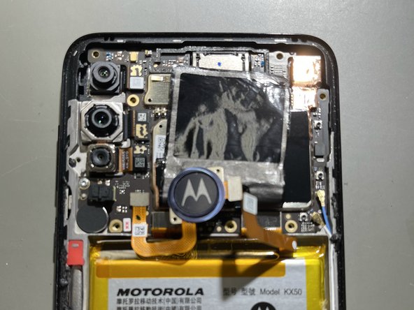

  3. Motorola Moto G Stylus (2020) Charging Port Board Replacement: crwdns2935265:03crwdnd2935265:01crwdnd2935265:02crwdne2935265:0 Motorola Moto G Stylus (2020) Charging Port Board Replacement: crwdns2935265:03crwdnd2935265:02crwdnd2935265:02crwdne2935265:0
    • Remove the back panel taking care not to tear the fingerprint reader flex cable.
    • There will be adhesive on the back panel and the phone frame that will need to be removed.
    • I recommend applying tesa tape in the same pattern when reassembling the phone (if you don't have the precut back panel adhesive).

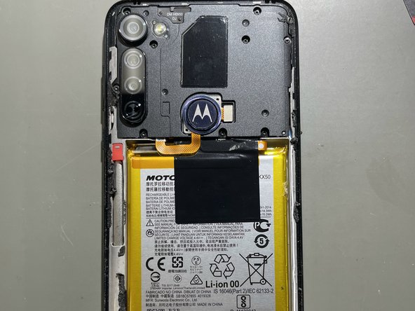

  4. Motorola Moto G Stylus (2020) Charging Port Board Replacement: crwdns2935265:04crwdnd2935265:01crwdnd2935265:03crwdne2935265:0 Motorola Moto G Stylus (2020) Charging Port Board Replacement: crwdns2935265:04crwdnd2935265:02crwdnd2935265:03crwdne2935265:0 Motorola Moto G Stylus (2020) Charging Port Board Replacement: crwdns2935265:04crwdnd2935265:03crwdnd2935265:03crwdne2935265:0
    • There are 9 T3 screws that have to be removed to gain access to the battery connector.
    • Once the screws are removed, use a plastic spudger to remove the logic board shield.
    • Lift up the black film and use a plastic tool to disconnect the battery flex from the logic board.

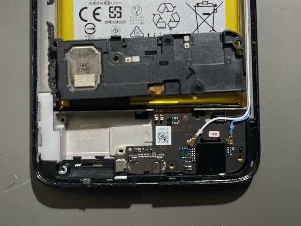

  5. Motorola Moto G Stylus (2020) Charging Port Board Replacement: crwdns2935265:05crwdnd2935265:01crwdnd2935265:02crwdne2935265:0 Motorola Moto G Stylus (2020) Charging Port Board Replacement: crwdns2935265:05crwdnd2935265:02crwdnd2935265:02crwdne2935265:0
    • There are 6 T3 screws that need to be removed.
    • Once the screws are removed, use a plastic spudger to lift up the loud speaker assembly.

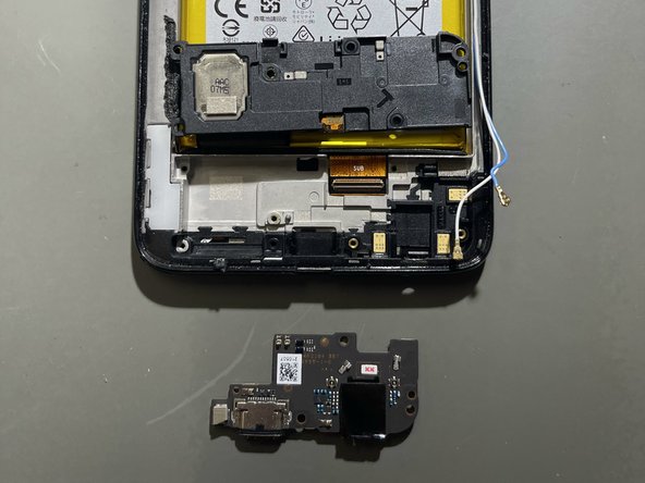

  6. Motorola Moto G Stylus (2020) Charging Port Board Replacement: crwdns2935265:06crwdnd2935265:01crwdnd2935265:02crwdne2935265:0 Motorola Moto G Stylus (2020) Charging Port Board Replacement: crwdns2935265:06crwdnd2935265:02crwdnd2935265:02crwdne2935265:0
    • Disconnect the 2 antenna wires by gently lifting at the connection point.
    • Lift up on the charing port board from the top and gently press down on the flex cable that is sitting under it. Remove from the phone frame.
