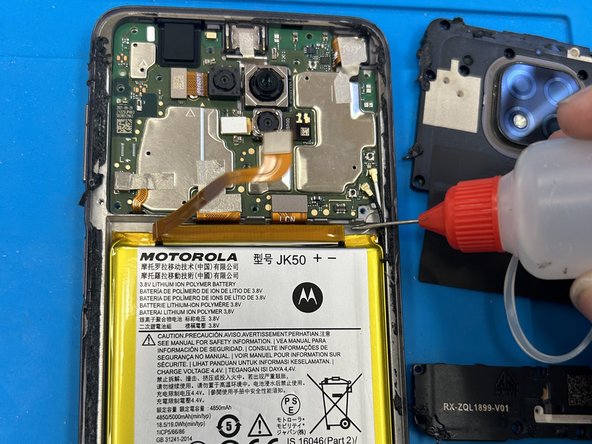

  4. Motorola Moto G Power (2021) Frameless LCD Replacement, Removing battery: crwdns2935265:04crwdnd2935265:01crwdnd2935265:03crwdne2935265:0 Motorola Moto G Power (2021) Frameless LCD Replacement, Removing battery: crwdns2935265:04crwdnd2935265:02crwdnd2935265:03crwdne2935265:0 Motorola Moto G Power (2021) Frameless LCD Replacement, Removing battery: crwdns2935265:04crwdnd2935265:03crwdnd2935265:03crwdne2935265:0
    • Unplug the battery connector with a spudger
    • Apply 100% isopropyl alcohol to the edges of the battery. Wait one minute to let the alcohol loosen the adhesive.
    • Pry the battery up carefully. Remove & set aside.

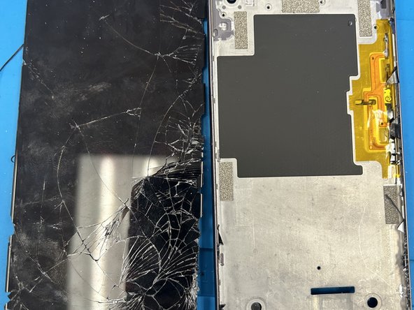

  5. Motorola Moto G Power (2021) Frameless LCD Replacement, remove lcd: crwdns2935265:05crwdnd2935265:01crwdnd2935265:03crwdne2935265:0 Motorola Moto G Power (2021) Frameless LCD Replacement, remove lcd: crwdns2935265:05crwdnd2935265:02crwdnd2935265:03crwdne2935265:0 Motorola Moto G Power (2021) Frameless LCD Replacement, remove lcd: crwdns2935265:05crwdnd2935265:03crwdnd2935265:03crwdne2935265:0
    • heat lcd(can use decent amount of heat to remove)
    • insert opening tool and slide around the perimeter of the LCD to slice the adhesive

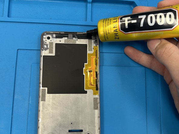

    • clean off old adhesive, then apply new glue(either double sided sticky tape or adhesive)

    • remove most of the old adhesive
    • apply either double sided sticky tape or adhesive glue and put the plastic back cover on
