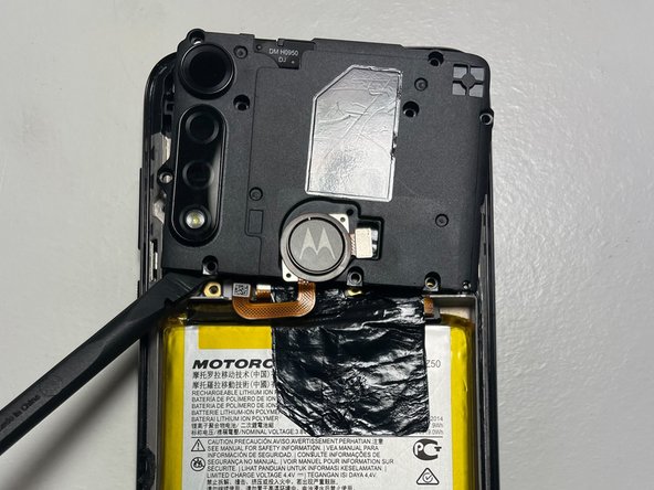

  6. Motorola Moto G Power (2020) Fingerprint Sensor Replacement: crwdns2935265:06crwdnd2935265:01crwdnd2935265:01crwdne2935265:0
    • Carefully use the spudger to lift the sensor cable, disconnecting the fingerprint sensor from the motherboard.
    • WARNING: Handle the sensor cable with care; it can be easily damaged.
  7. Motorola Moto G Power (2020) Fingerprint Sensor Replacement: crwdns2935265:07crwdnd2935265:01crwdnd2935265:01crwdne2935265:0
    • Carefully remove the fingerprint sensor from the device and set it aside.
    • Do not use excessive force when lifting the back cover or any other component.
