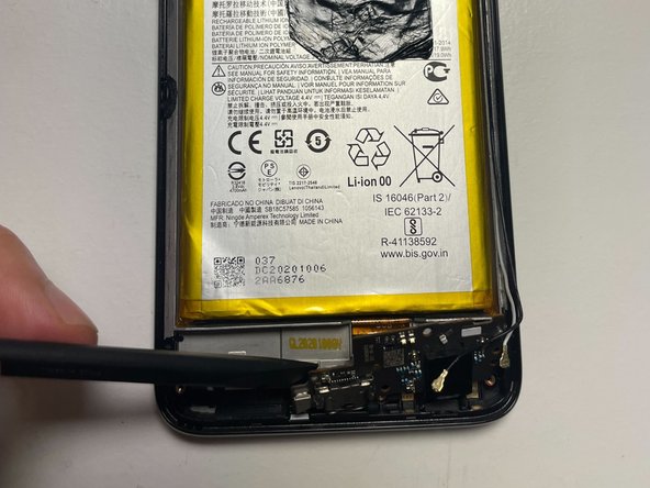

  4. Motorola Moto G Power (2020) Charging Port Replacement, Charging Port: crwdns2935265:04crwdnd2935265:01crwdnd2935265:01crwdne2935265:0
    • Using the tool T3 Torx screwdriver user must carefully remove 3 1.8mm screws helping to secure the part.
  5. Motorola Moto G Power (2020) Charging Port Replacement: crwdns2935265:05crwdnd2935265:01crwdnd2935265:02crwdne2935265:0 Motorola Moto G Power (2020) Charging Port Replacement: crwdns2935265:05crwdnd2935265:02crwdnd2935265:02crwdne2935265:0
    • In order to not damage the devices components slowly lift the bottom cover using a needed tool the spudger.
  6. Motorola Moto G Power (2020) Charging Port Replacement: crwdns2935265:06crwdnd2935265:01crwdnd2935265:02crwdne2935265:0 Motorola Moto G Power (2020) Charging Port Replacement: crwdns2935265:06crwdnd2935265:02crwdnd2935265:02crwdne2935265:0
    • Carefully pry the metal connectors that are attached to the cables with the sudger
    • secondly, on the right side of the device slowly disconnect the two cables from the charge port.
    • Cables are color coded one white wire and one black wire
  7. Motorola Moto G Power (2020) Charging Port Replacement: crwdns2935265:07crwdnd2935265:01crwdnd2935265:02crwdne2935265:0 Motorola Moto G Power (2020) Charging Port Replacement: crwdns2935265:07crwdnd2935265:02crwdnd2935265:02crwdne2935265:0
    • Using a spudger carefully raise the charging port out of your device
    • Light pressure needed to loosen the adhesive
    • Avoid using excessive force to prevent component damge
  8. Motorola Moto G Power (2020) Charging Port Replacement: crwdns2935265:08crwdnd2935265:01crwdnd2935265:01crwdne2935265:0
    • Gently slide the charging port of the device while avoiding component damage.

This guide is good, but understates the ease of taking the back off. There is adhesive holding it on, and it took a heat gun and a LOT of force to pry it open. I only found out when I was trying to tell which of the two shell grooves I needed to pry open (the back one, since there's no side view) and found a different guide on Youtube, and saw them using a heating pad. I also couldn't tell WHICH 3 screws of the 5 were necessary to remove, so I just did all 5. Some circling would help!
Outside of that, thank you so much for the guide, I fixed my first phone all by my self! Minus borrowing my dad's heat gun and the two of us working together to pry the case open, seriously that was the hardest part. Once the case is open, the rest is EASY!! Now to get the dang case back on...
