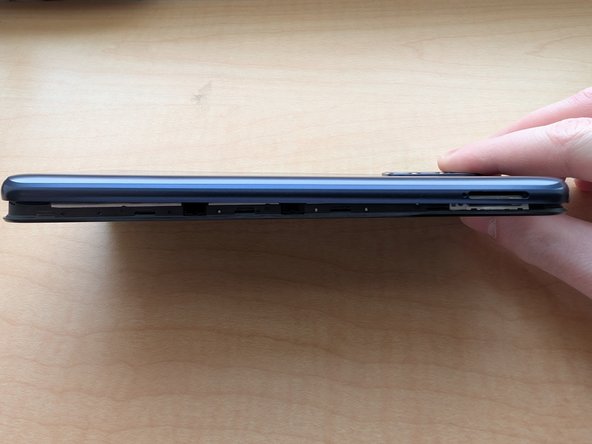

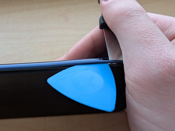

  2. Motorola Moto G Play (2023) Teardown, Remove part of the back plate: crwdns2935265:02crwdnd2935265:01crwdnd2935265:03crwdne2935265:0 Motorola Moto G Play (2023) Teardown, Remove part of the back plate: crwdns2935265:02crwdnd2935265:02crwdnd2935265:03crwdne2935265:0 Motorola Moto G Play (2023) Teardown, Remove part of the back plate: crwdns2935265:02crwdnd2935265:03crwdnd2935265:03crwdne2935265:0
    • The back plate is very fragile in some areas, so be careful when prying. These areas are the SIM slot, power and volume buttons, headphone jack, and camera bezel.
    • Insert a shimmy tool in the SIM slot, into the edge of the plate, to create a gap. Then, insert a pick into the gap, and slide it across the edge of the phone, to unclip the plate.
    • Do not try to unclip the part around the camera. We will save that for step 4.

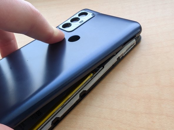

  3. Motorola Moto G Play (2023) Teardown, Push the fingerprint sensor out of the back plate: crwdns2935265:03crwdnd2935265:01crwdnd2935265:01crwdne2935265:0
    • While carefully lifting the back plate up, push the fingerprint sensor down to separate it from the plate.
    • Again, take caution when lifting the back plate, as to not damage the area around the headphone jack, and volume buttons.

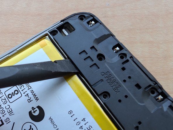

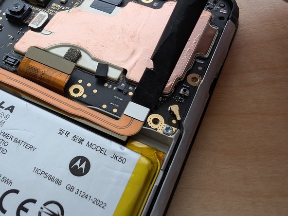

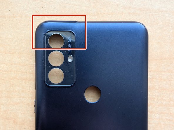

  4. Motorola Moto G Play (2023) Teardown, Completely removing the back plate: crwdns2935265:04crwdnd2935265:01crwdnd2935265:03crwdne2935265:0 Motorola Moto G Play (2023) Teardown, Completely removing the back plate: crwdns2935265:04crwdnd2935265:02crwdnd2935265:03crwdne2935265:0 Motorola Moto G Play (2023) Teardown, Completely removing the back plate: crwdns2935265:04crwdnd2935265:03crwdnd2935265:03crwdne2935265:0
    • Insert a spudger into the phone, to separate some of the glue from the phone.
    • Be careful not to poke the battery, or the fingerprint sensor and it's ribbon cable.
    • Again, be careful as to not bend the plastic around the headphone jack, as I did on accident (shown on image 3). These things suck!

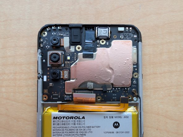

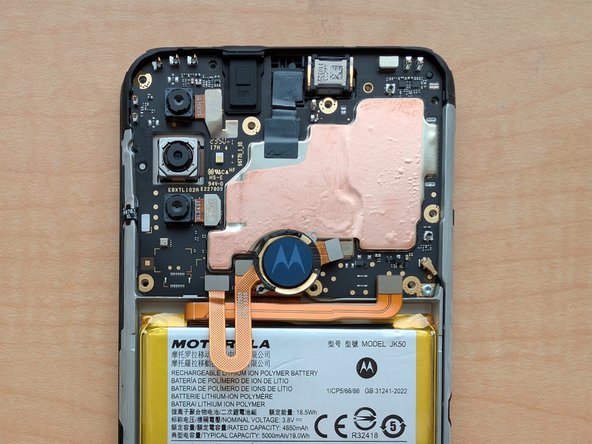

  5. Motorola Moto G Play (2023) Teardown, Remove the motherboard cover: crwdns2935265:05crwdnd2935265:01crwdnd2935265:03crwdne2935265:0 Motorola Moto G Play (2023) Teardown, Remove the motherboard cover: crwdns2935265:05crwdnd2935265:02crwdnd2935265:03crwdne2935265:0 Motorola Moto G Play (2023) Teardown, Remove the motherboard cover: crwdns2935265:05crwdnd2935265:03crwdnd2935265:03crwdne2935265:0
    • Using a TORX T5 bit, unscrew and remove the screws shown with the red circles. Then, lift out the cover.

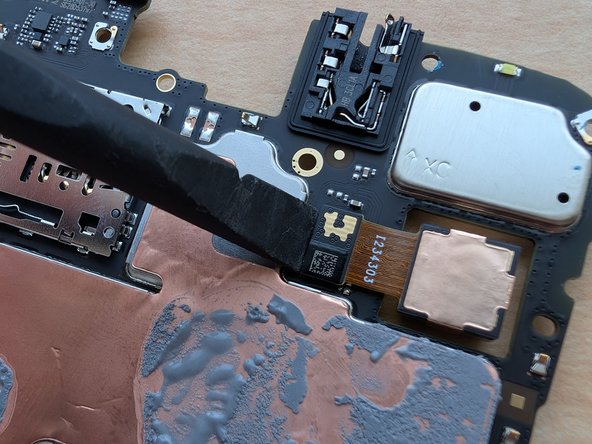

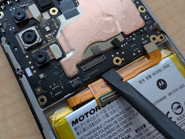

  6. Motorola Moto G Play (2023) Teardown, Remove connections: crwdns2935265:06crwdnd2935265:01crwdnd2935265:03crwdne2935265:0 Motorola Moto G Play (2023) Teardown, Remove connections: crwdns2935265:06crwdnd2935265:02crwdnd2935265:03crwdne2935265:0 Motorola Moto G Play (2023) Teardown, Remove connections: crwdns2935265:06crwdnd2935265:03crwdnd2935265:03crwdne2935265:0
    • Remove the fingerprint sensor, screen/daughterboard, and battery ribbon cables, with the spudger.

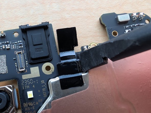

  7. Motorola Moto G Play (2023) Teardown, Disconnect the antenna from the motherboard: crwdns2935265:07crwdnd2935265:01crwdnd2935265:02crwdne2935265:0 Motorola Moto G Play (2023) Teardown, Disconnect the antenna from the motherboard: crwdns2935265:07crwdnd2935265:02crwdnd2935265:02crwdne2935265:0
    • Using the spudger tool, pry the WiFi antenna out of the motherboard.

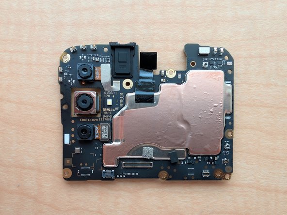

  8. Motorola Moto G Play (2023) Teardown, Remove the motherboard: crwdns2935265:08crwdnd2935265:01crwdnd2935265:03crwdne2935265:0 Motorola Moto G Play (2023) Teardown, Remove the motherboard: crwdns2935265:08crwdnd2935265:02crwdnd2935265:03crwdne2935265:0 Motorola Moto G Play (2023) Teardown, Remove the motherboard: crwdns2935265:08crwdnd2935265:03crwdnd2935265:03crwdne2935265:0
    • Using a TORX T5 bit, remove the screw at the bottom corner of the motherboard, highlighted in red. Then, using the spudger, pry the motherboard out of the body.

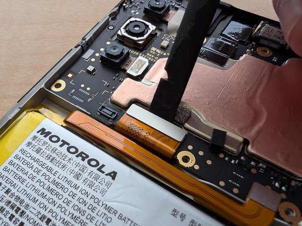

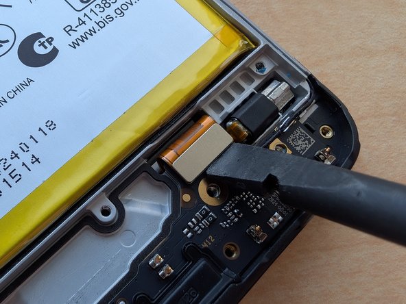

  9. Motorola Moto G Play (2023) Teardown, Remove the cameras: crwdns2935265:09crwdnd2935265:01crwdnd2935265:03crwdne2935265:0 Motorola Moto G Play (2023) Teardown, Remove the cameras: crwdns2935265:09crwdnd2935265:02crwdnd2935265:03crwdne2935265:0 Motorola Moto G Play (2023) Teardown, Remove the cameras: crwdns2935265:09crwdnd2935265:03crwdnd2935265:03crwdne2935265:0
    • Using a spudger, pry the cameras out of their connectors on the motherboard. There are 3 cameras connected on the front of the board, and one on the back. Peel the tape off with the camera, if need be.

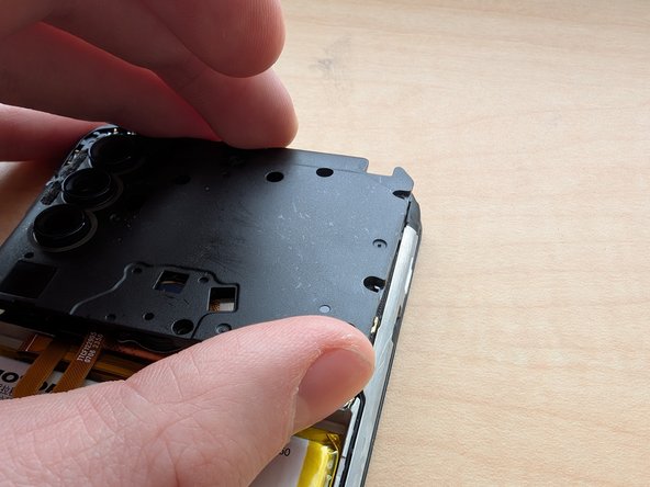

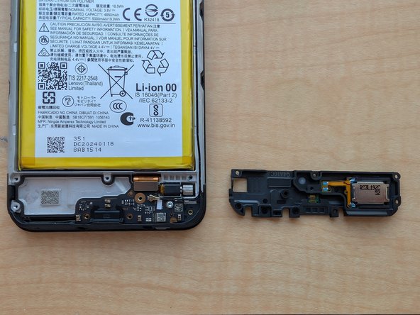

  10. Motorola Moto G Play (2023) Teardown, Remove the daughterboard plate: crwdns2935265:010crwdnd2935265:01crwdnd2935265:03crwdne2935265:0 Motorola Moto G Play (2023) Teardown, Remove the daughterboard plate: crwdns2935265:010crwdnd2935265:02crwdnd2935265:03crwdne2935265:0 Motorola Moto G Play (2023) Teardown, Remove the daughterboard plate: crwdns2935265:010crwdnd2935265:03crwdnd2935265:03crwdne2935265:0
    • Again, using a TORX T5 bit, unscrew the screws highlighted in red. Then, use a spudger to lift the plate out.

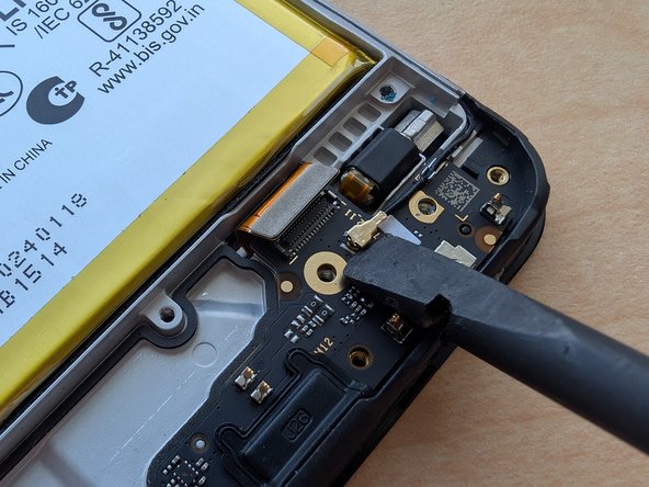

  11. Motorola Moto G Play (2023) Teardown, Disconnecting stuff from the daughterboard: crwdns2935265:011crwdnd2935265:01crwdnd2935265:03crwdne2935265:0 Motorola Moto G Play (2023) Teardown, Disconnecting stuff from the daughterboard: crwdns2935265:011crwdnd2935265:02crwdnd2935265:03crwdne2935265:0 Motorola Moto G Play (2023) Teardown, Disconnecting stuff from the daughterboard: crwdns2935265:011crwdnd2935265:03crwdnd2935265:03crwdne2935265:0
    • Use a TORX T5 bit to remove the screw - highlighted in red - holding in the board. Then, use a spudger to disconnect the ribbon and antenna cables.

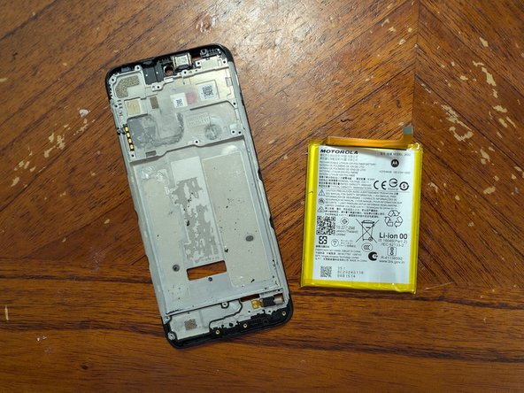

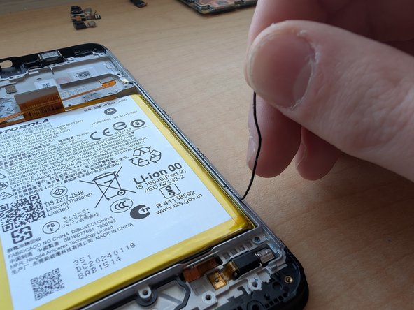

  13. Motorola Moto G Play (2023) Teardown, Removing the battery: crwdns2935265:013crwdnd2935265:01crwdnd2935265:02crwdne2935265:0 Motorola Moto G Play (2023) Teardown, Removing the battery: crwdns2935265:013crwdnd2935265:02crwdnd2935265:02crwdne2935265:0
    • Heat the front of the phone up a little bit with a hair dryer or heat gun, then use an old credit card to lift out the battery.
    • Do not poke the battery, and make sure it's been discharged. Also, do not heat the phone up to the point it gets too hot.
    • Be very careful when using isopropyl alcohol to loosen the glue! Otherwise, it will leak into the LCD and damage it.

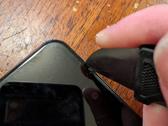

  15. Motorola Moto G Play (2023) Teardown, Seperate the screen from the frame: crwdns2935265:015crwdnd2935265:01crwdnd2935265:02crwdne2935265:0 Motorola Moto G Play (2023) Teardown, Seperate the screen from the frame: crwdns2935265:015crwdnd2935265:02crwdnd2935265:02crwdne2935265:0
    • Using a hair dryer or heat gun, heat up the front of the phone, until it becomes warm to the touch. Then, wedge a jimmy tool in between the frame and the screen, and glide it across the perimeter of the display.
    • Only insert the jimmy about 2mm into the screen bezel, otherwise, you will ruin the display.
