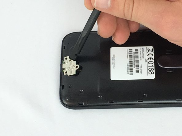

  8. Motorola Moto G 3rd Generation Charging Port Replacement, Charging Port: crwdns2935265:08crwdnd2935265:01crwdnd2935265:01crwdne2935265:0
    • Remove the three 3.0 mm T4 screws from the charging port cover.
    • Remove the charging port cover.
  9. Motorola Moto G 3rd Generation Charging Port Replacement: crwdns2935265:09crwdnd2935265:01crwdnd2935265:01crwdne2935265:0
    • If the charging port is secured with adhesive, use a heat gun around the charging port for ten seconds to loosen the adhesive.
    • Do not heat the area for too long. Excess heat can damage the phone.
  10. Motorola Moto G 3rd Generation Charging Port Replacement: crwdns2935265:010crwdnd2935265:01crwdnd2935265:02crwdne2935265:0 Motorola Moto G 3rd Generation Charging Port Replacement: crwdns2935265:010crwdnd2935265:02crwdnd2935265:02crwdne2935265:0
    • Use a spudger to push out the charging port from the inside of the case and pry it off from the outside of the case.

Is all this necessary? There is a youtube teardown that states the usb port should be replaceable from just the 3 screws, so no glue gun, no screen removal etc. So just step 9.
So is this repair accurate?
Brendan L - crwdns2934203:0crwdne2934203:0
Step 10 tells you to push out the charging port from inside the case, which would require first removing the screen. Maybe it's possible to just remove the charging port from outside the case like in the video, but it may require a lot of force and pushing it out from inside is just easier.
Ahnaf Siddiqui -
I mean I replace my charging port every 6 months now and I the only thing I do is unscrew the charging port area and get a tiny flathead bit after applying heat and pull off the metal plate. After that, I insert the flathead into the bottom of the charging port from where it plugs and push it outwards.
nikomarquez2013 -
No, it’s not I did sucesfullz replaced microusb port in mz G3 simplz bz removing screws, pulling port from the outside with ?a?little? more force, replacing it and screwing back. 5 minutes, nothing but T4 torx screwdriver.
