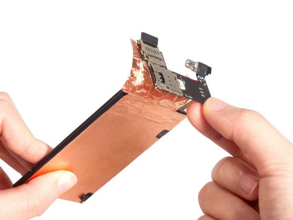

  6. Motorola Moto G 2nd Generation Teardown: crwdns2935265:06crwdnd2935265:01crwdnd2935265:01crwdne2935265:0
    • At that time, remove the battery with SIM & SD card reader assembly together.

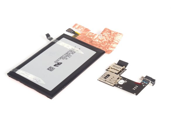

  7. Motorola Moto G 2nd Generation Teardown: crwdns2935265:07crwdnd2935265:01crwdnd2935265:03crwdne2935265:0 Motorola Moto G 2nd Generation Teardown: crwdns2935265:07crwdnd2935265:02crwdnd2935265:03crwdne2935265:0 Motorola Moto G 2nd Generation Teardown: crwdns2935265:07crwdnd2935265:03crwdnd2935265:03crwdne2935265:0
    • Separate battery and SIM & SD card reader assembly.

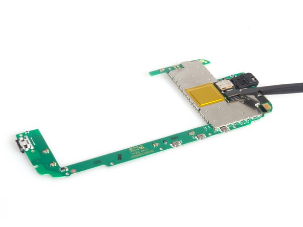

  10. Motorola Moto G 2nd Generation Teardown: crwdns2935265:010crwdnd2935265:01crwdnd2935265:03crwdne2935265:0 Motorola Moto G 2nd Generation Teardown: crwdns2935265:010crwdnd2935265:02crwdnd2935265:03crwdne2935265:0 Motorola Moto G 2nd Generation Teardown: crwdns2935265:010crwdnd2935265:03crwdnd2935265:03crwdne2935265:0
    • Remove screws on the motherboard and the motherboard can be removed easily.

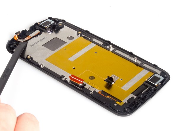

  13. Motorola Moto G 2nd Generation Teardown: crwdns2935265:013crwdnd2935265:01crwdnd2935265:02crwdne2935265:0 Motorola Moto G 2nd Generation Teardown: crwdns2935265:013crwdnd2935265:02crwdnd2935265:02crwdne2935265:0
    • Remove earpiece and loudspeaker.
